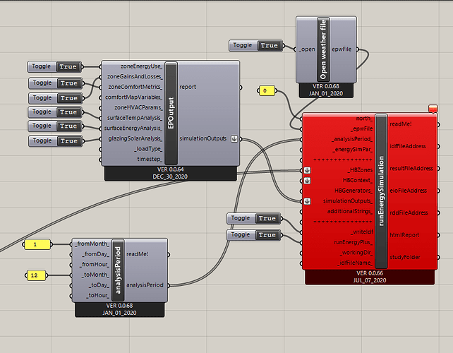

Hello everyone

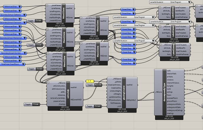

I am a new user and I am having some issues with running the energy simulation in my file. Unfortunately the threads on the forum or the proposed solutions have not helped me to solve the issue.
As you can see my energy simulation component shows an error after trying to run it…
This is the error message
- The simulation has not run correctly because of this severe error:
** Severe ** [ShadowCalculation][ShadowCalculation 1][shading_calculation_method] - “AverageOverDaysInFrequency” - Failed to match against any enum values. - The simulation has not run correctly because of this severe error:
** Severe ** [ShadowCalculation][ShadowCalculation 1][shading_calculation_update_frequency_method] - “30” - Failed to match against any enum values. - The simulation has failed because of this fatal error:
** Fatal ** Errors occurred on processing input file. Preceding condition(s) cause termination.
Any help with this would be appreciated, thank you!
