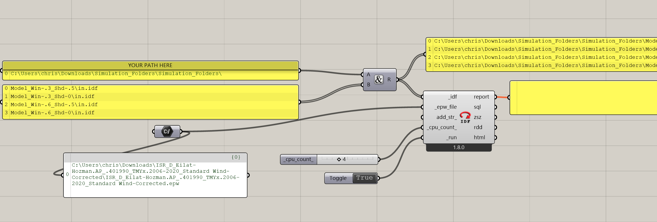

Running a bunch of IDF files with the RunIDF component is giving me the following error:
Runtime error (AggregateException): One or more errors occurred.
Traceback:
line 202, in run_function_in_parallel, “C:\Program Files\ladybug_tools\python\Lib\site-packages\ladybug_rhino\grasshopper.py”
line 133, in script
The thing is that the simulations were performed OK. I get all results in the respective output folders. But the outputs of the component are empty [of course, because of the error].
I’m running the files in parallel.
Any ideas?
Thanks,

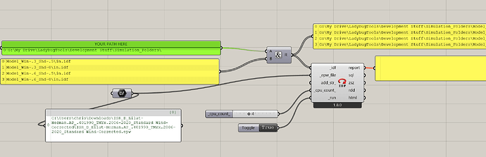

Hi @chris ,
Running by 1 works fine for all cases.
Attached the necessary files to recreate the issue.
Thanks!!
Simulation_Folders.zip (44.4 KB)
RunIDF.gh (23.3 KB)

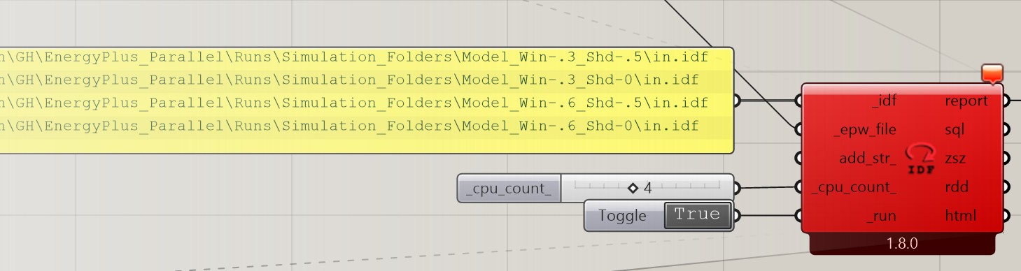

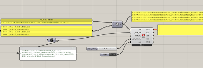

Hey @AbrahamYezioro ,
Running with 1 CPU works:
… and it works just as well if I run it with 4 CPUs:
Is there something else that you can think of that I might be missing to recreate the error?
Hi @chris,
At first it can be related that i was saving the simulations over the cloud [onedrive]. Tested saving on the local machine and … it isn’t the problem.
Tried with the EPW link I sent in the GH above and it works OK.
So the problem appears when using ANY of my local EPW files.
Can you try with the attached here?
ISR_D_Eilat-Hozman.AP_.401990_TMYx.2006-2020_Standard Wind-Corrected.zip (254.8 KB)
I’m pretty sure it wont work now, even for you :slight_smile:
Just to add, the simulations are done fine. They don’t fail. Just at the end the component fails showing the error. As a result the outputs are missing.

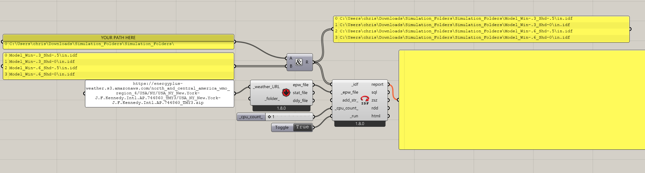

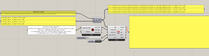

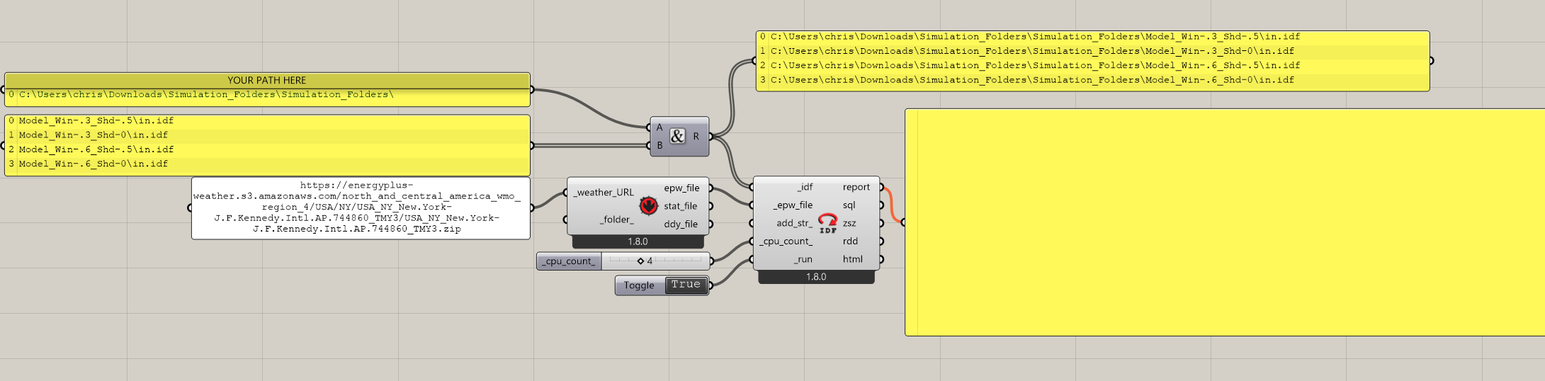

I tried it with your EPW file and it still worked well for me:
Maybe the writing of files to the cloud was what caused the problem. I imagine that, if your internet connection wasn’t perfect and it dropped for a millisecond during the run, you could get an error that was mostly undetectable from just looking at the result files but would be caught in the whole process.
At least that is my best guess until I can find a way to recreate the issue.

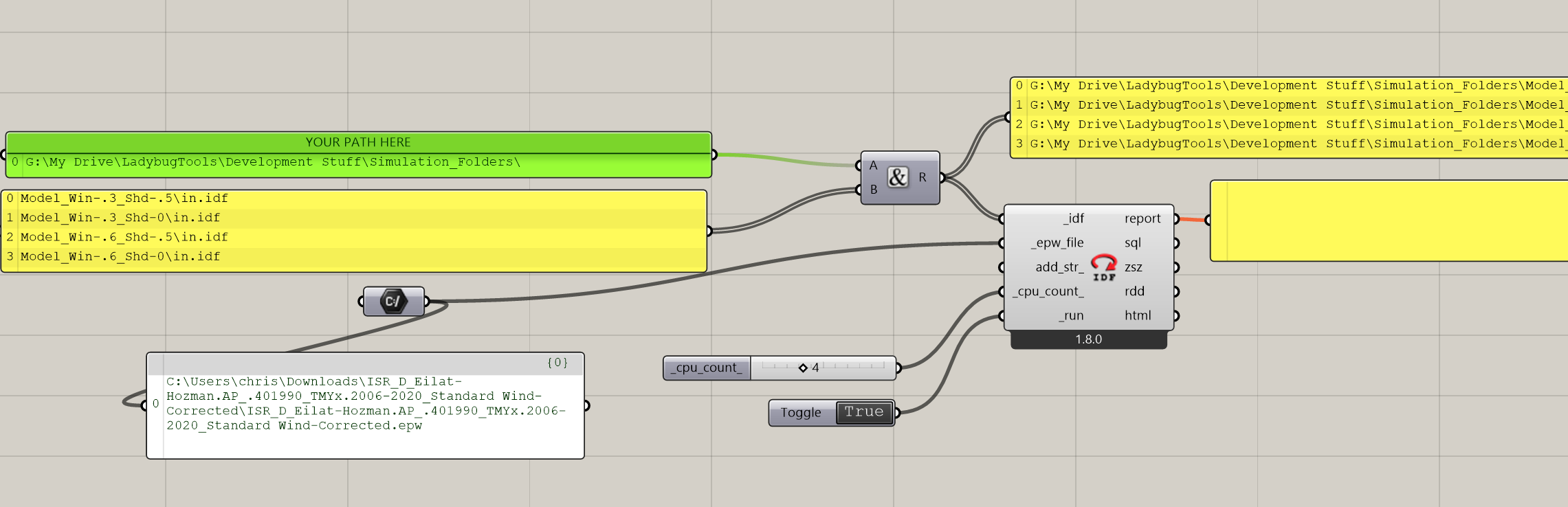

For good measure, I tried to see if I could recreate the error by moving the simulation to my google drive but it all still worked:
So I’m at a loss for a better explanation other than maybe your connection to your cloud drive dropped for a few milliseconds.

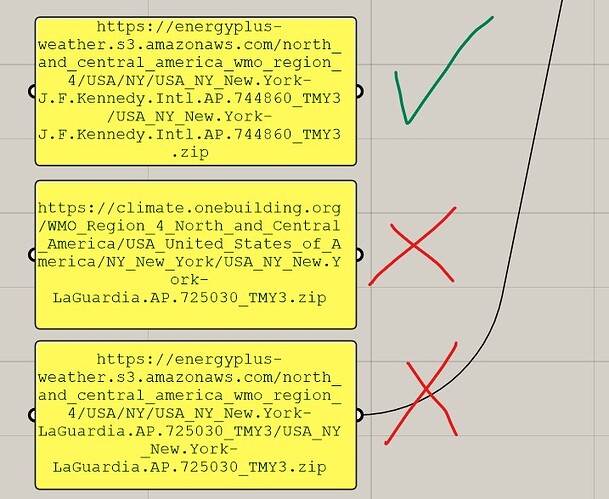

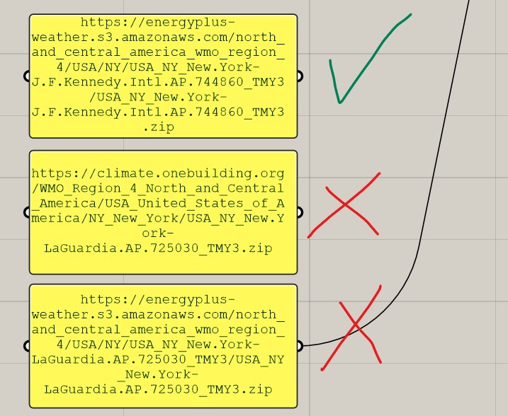

Hi again @chris,
Can’t let go … :slight_smile:
Tried some other EPWs, not only my local ones. To my surprise i see that the NY Kennedy comes through but NY La Guardia [onebuilding and energyplus] don’t.
Something to think about?
