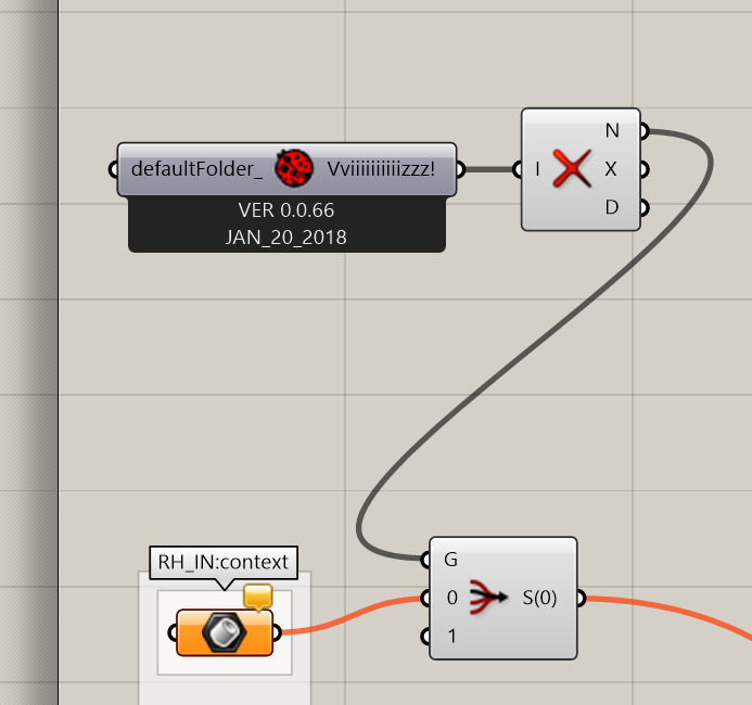

It does look at it still requires the LadyBug_LadyBug component to run before everything else to run otherwise it will return the error “You should first let Ladybug fly…”
This error can be avoided by using forcing all other components to run after LadyBug_LadyBug does by:
