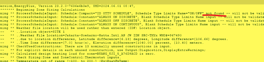

I tried running with the “Run Idf” component and the result was also not found

The fact that E+ gives you a warning about an extra unused schedule in your IDF is not a bug. EnergyPlus gives tons of warnings because the E+ developers thought they would be useful to some people. But pretty much all of them can be ignored unless they are Severe. And even some of the Severe warnings are safe to ignore.
