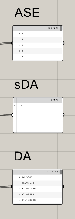

@devang @chris @mostapha I redid some components of the definition. But I still have the same results. It seems that is reading the surfaces fine, then why could it be giving an sDA of 100 and a ASE of 0?
Here is the updated script: annual_daylight_gridbased.gh (225.6 KB)
