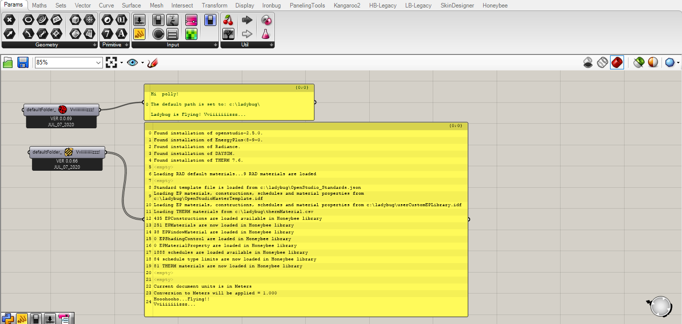

Thanks Abraham, I installed the latest version of LB (0.0.69) and HB (0.0.66) and I ran your file but on my computer it keeps giving me the same error. I use Open Studio 2.5.0.
Wonder which OpenStudio are you using?
I apologize for the late reply. I use Open Studio 2.5.0 because this was the recommended version.
