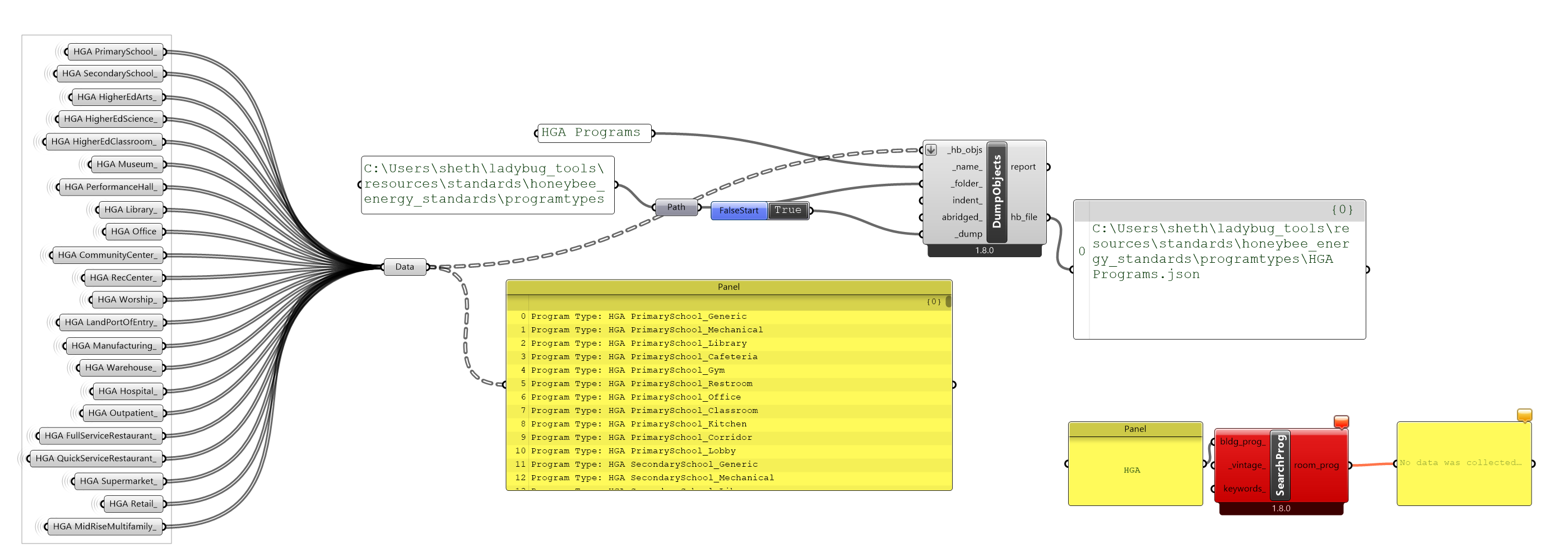

Hi @chris,
I created a .json file for the program types and schedules in the respective energy standards folders. But for some reason, the search program is not reading the new programs and schedules from the .json file. I also tried the load objects component, still nothing. Could you tell what might be going wrong.
Hi @chris
@Hetvi.Sheth and I are working on this issue together: To expand on this problem…
We are able to create a custom program types .json file and successfully ‘Dump’ it to the Honeybee Energy Standards > Program Types folder. These custom programs can be found when searching using the ‘SearchPrograms’ ’ component.
However, we cannot replicate the same process when attempting to write a custom schedules.json file. Using a similar method as for programs, we use the ‘Dump Objects’ component to save the .json file to the Honeybee Energy Standards > Schedules folder. However, it is not findable using the ‘SearchPrograms’ component. We can successfully load it using the file path, but cannot seem to successfully pull the custom schedules.json data into the grasshopper file using the Search Schedules components. It seems that this schedules.json file is not findable.
Interestingly, this issue seems to have arisen when switching from Windows 10 to Windows 11.
Attached is a simplified .gh file demonstrating our attempted process. Any assistance with writing the custom schedules .json file is much appreciated.
Test File_Custom Programs_250624.gh (97.4 KB)
Sorry for such a late response, @molly .
You aren’t really writing the schedules into the location that is recommended for a custom library. The best practice is to write them here:
C:\Users\[USERNAME]\AppData\Roaming\ladybug_tools\standards
This has the benefit that it is never uninstalled or overwritten as you update Ladybug Tools. Also, you are not able to write files into Program Files unless you are running the application in Admin mode. Perhaps this could explain why things were not working the way that you expected.
