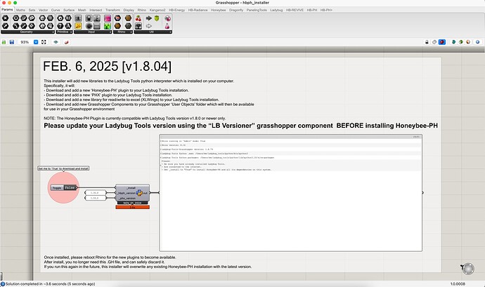

  1. We have offloaded most of the ‘work’ to dedicated libraries which we host on PyPi (Honeybee-PH, PHX, PH-Units).
  2. For installation, we make available a .gh file which includes an ‘installer’ GH-component patterned on the old Honeybee Food4Rhino installer (pre-Pollination). This installer file allows the user to click ‘install’ in GH, and all the necessary back-end setup is done for them.
  3. When run, this installer component runs pip install ... for the required packages against the ladybug-tools python installation.
  4. It also downloads the .gh components from our GitHub repository and puts them in the user’s Rhino directory so they are available on Rhino’s restart.

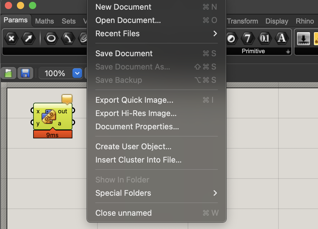

From the installer, I see .ghuser files get copied into Grasshopper\UserObjects, but I’m not clear on what the development side looks like.
Do you keep components inside a large .gh file and edit them there, then export/update both the .ghuser and .py from the canvas (e.g. using something like the Export UserObject component)?
Or do you write the logic directly in .py files and then generate the .ghuser files from that? I am very tempted to follow this approach, and maybe use something like COMPAS’ componentizer.

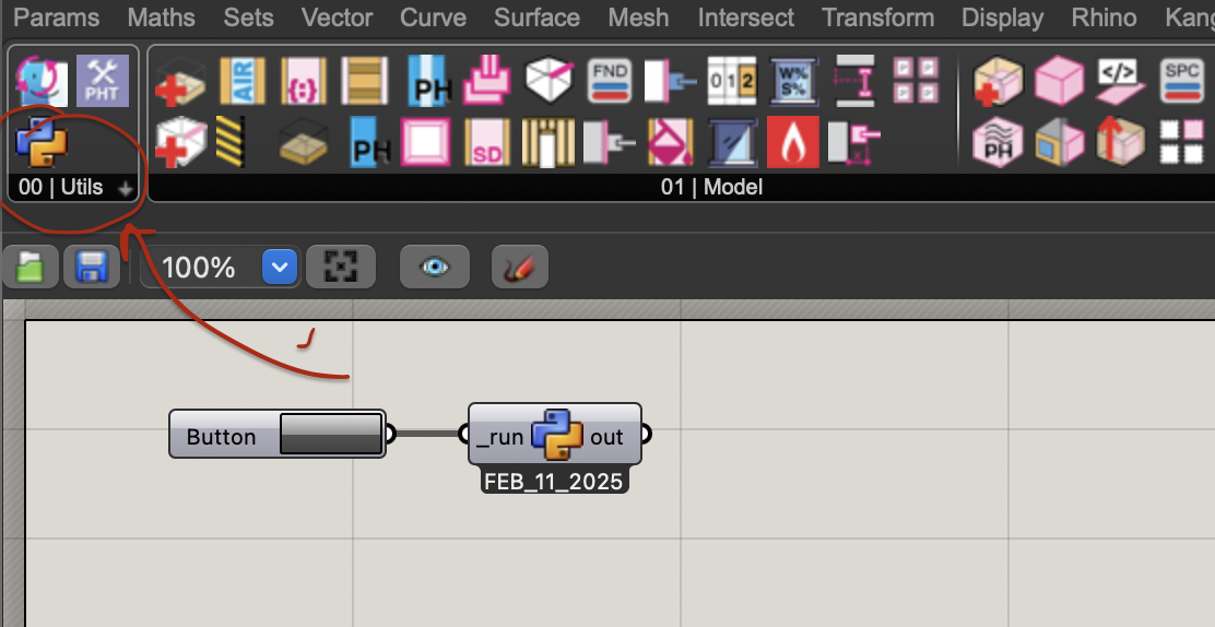

Hi @gzorzeto , Thats a good question: the component part is the most manual piece. Most everything else is automated except this. The way I currently do it is that I develop new components ‘as-needed’, and use the manual Rhino/Grasshoper ‘Create User Object’:
Once built though, I have a small utility component that handles the wrest: It grabs the ghuser file, pulls out the actual python code, and saves both the .ghuser and a backup .py file to my ‘dev’ directory. I run it manually from within Grasshopper after completing the component construction:
This way I can keep the ghuser and script in my dev repo with version-control and distribute them from there.
It is not great, but I am not aware of any auomtated way to manage those user-object ghuser files? Would be super curious it there is! But thanks to the ‘facade’ pattern here, the components themselves almost never really change once built -the ‘work’ all happens in the behind-the-scenese scripts, which are normal .py files and can be managed using normal automation tooling.
hope that helps!!
