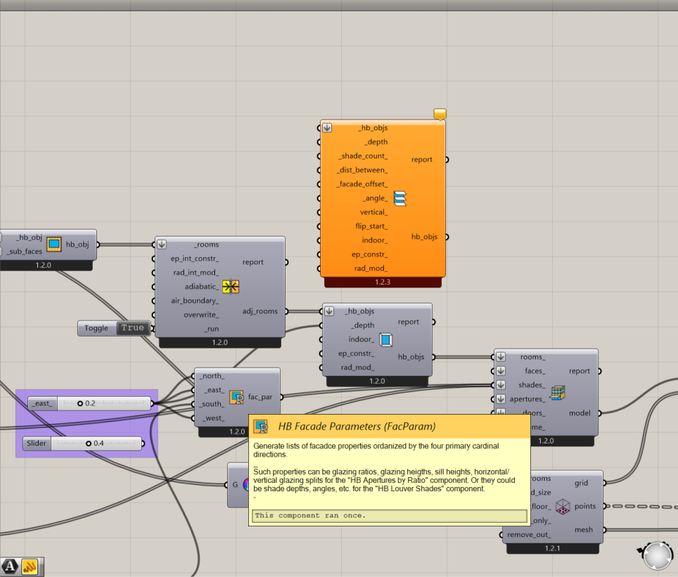

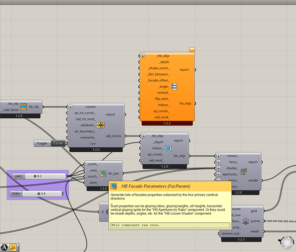

Hey @chris will it be possible to change the shade depth by facade orientation for the Extruded Border Shades component in future? It seems it can only be used for the Louver Shades component at the moment

Yes, I was mostly waiting for someone to ask for this one. I just implemented it:
It will be in the LBT 1.3 release later this week.
