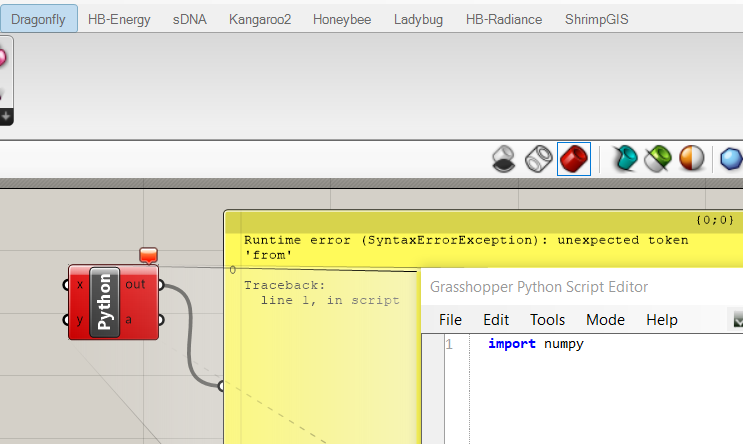

My ShrimpGIS installation wasn’t working anymore with exactly this error message:
And after founding this Github issue I discovered it is an issue between their installation and from LBT. ShrimpGIS plugin installation does not work when in combination with LBT versions 1.5 and 1.6.
Does anyone have a hint on what the issue could be?
I reproduced this issue on Rhino7 with ShrimpGIS 1.03 and LBT 1.6 on Windows 10

The fundamental issue is still there in Grasshopper, and is being caused by LadyBug Tools.
I don’t know how on earth you guys have managed to install numpy into GhPython - that’s really impressive! I take my hat off. But unfortunately when LadyBug Tools is installed, and any other GhPython component does:
import numpy
the following error is raised:
I know all too well that coding for GhPython can be incredibly challenging. That’s unfortunate that nothing else can make use of the numpy version LadyBug tools has managed to install. Of greater concern is what happens when the user installs a different plug in, or manages to install their own numpy version.
It would be much better if Lady Bug linked to its own local numpy installation (e.g. using relative imports to its own code, and static linking) and did not change the globally available imports for all other plug-ins (even if they could be better designed).
However, I think I’ve fixed this for shrimpGIS at least. I don’t actually know how to use shrimpGIS or LadyBug Tools, but the no-numpy version above got rid of the “from” error myself and Lisa had, together with LadyBug Tools being installed.
If you don’t want to trust random code downloaded from the internet, it is very straightforward to simply edit conversion.py in your existing shrimpGIS 1.03 zip file (shrimpGIS copies utm into %appdata%\shrimp_gis\utm so if you want to edit an already installed copy, the conversion.py might need changing there as well as in UserObjects):
