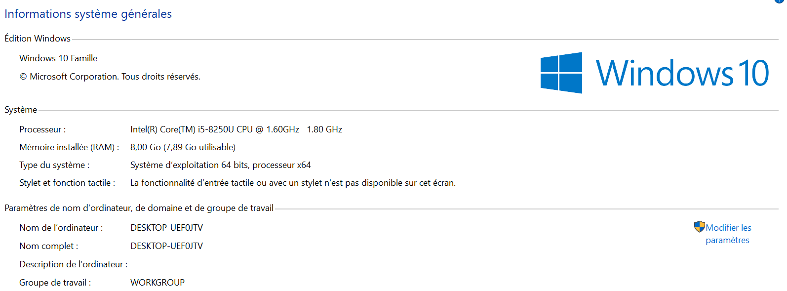

my laptop information in photo:

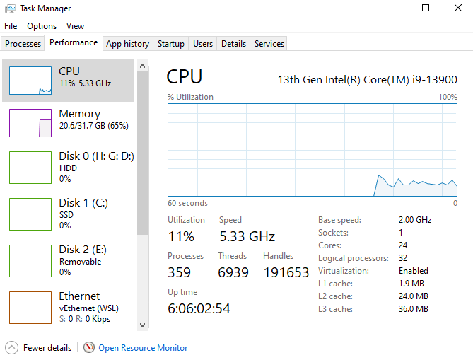

It’s very logical given those computer specs. I’m certainly not trying to show off here but this is the CPU of the machine that I typically use to run urban-scale energy simulations:
The processor has 24 cores and 32 threads. With the i9 architecture, I can usually tear through an urban model of a ~14 buildings in 2-6 minutes depending on the simulation parameters.
