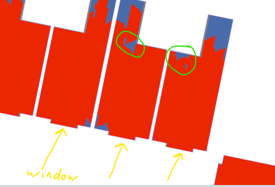

Hi everyone, i was looking to implement the HB Sky View so that i could see what parts of my rooms can see sky vs cant see sky.
i have attached an image below, i figured if the value gave out anything greater than 0 then that sensor can see a portion of the sky dome.
however i am seeing these bubble in the room where they cant see the sky dome but i don’t think that’s correct.
I am not sure if i have misunderstood the tool so any help would be greatly appreciated.
Hi @tturner, the banding you’re getting on the spatial heatmap makes it seem to me like something is going awry between matching your results to your mesh.
If you analyse a single room do you get the same result error?
Could you share a simplified script with the issue?
Cheers,
Charlie

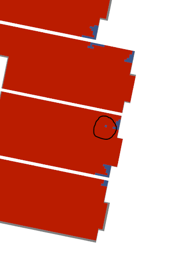

I have checked and i am still having the issues of these bubbles on my larger model. is it anything to do with the radiance parameters?
