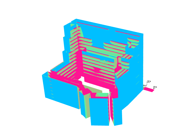

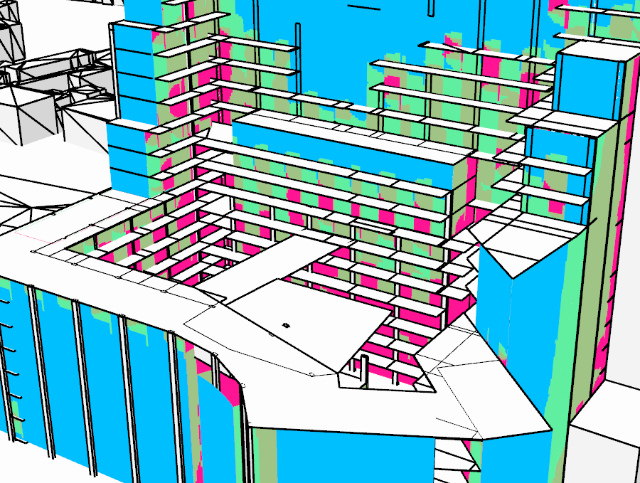

I am running a simple vertical sky component analysis. I find unexpected results when i add the solar protection devices, it report a checkered like pattern that does not match with the design.
Do you think the results are correct? in that case, how can i interpret them?,
if not, Have you ever had a similar problem? do you know how can this be fix?
Thanks
Results with solar protection

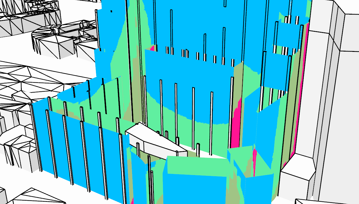

Results without solar protection

If anybody has a similar issue. This was solved by removing part of the context that was corrupting the results.
