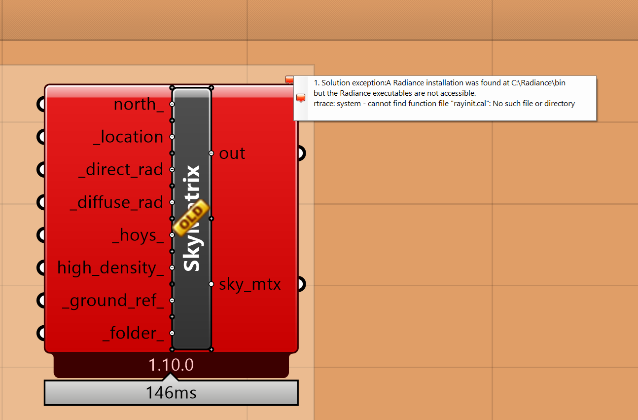

Skymatrix and radiance problem
  1. Solution exception:A Radiance installation was found at C:\Radiance\bin
    but the Radiance executables are not accessible.
    rtrace: system - cannot find function file “rayinit.cal”: No such file or directory
Radiance version used: Release Radiance 6.1a (2026-03-13) · LBNL-ETA/Radiance · GitHub : 6.1a
