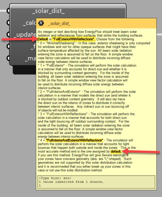

Hi @chris,
I believe you have a minor tooltip error here - from what I can tell “3” is the default and not “4”:
Hi @chris,
Yes, that’s a typo in the docs. Thanks for catching it and reporting it. I just pushed a fix:
