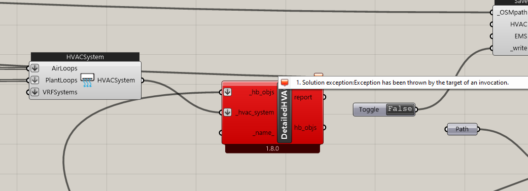

Solution exception:Exception has been thrown by the target of an invocation. when applying a detailed HVAC system to a honeybee object

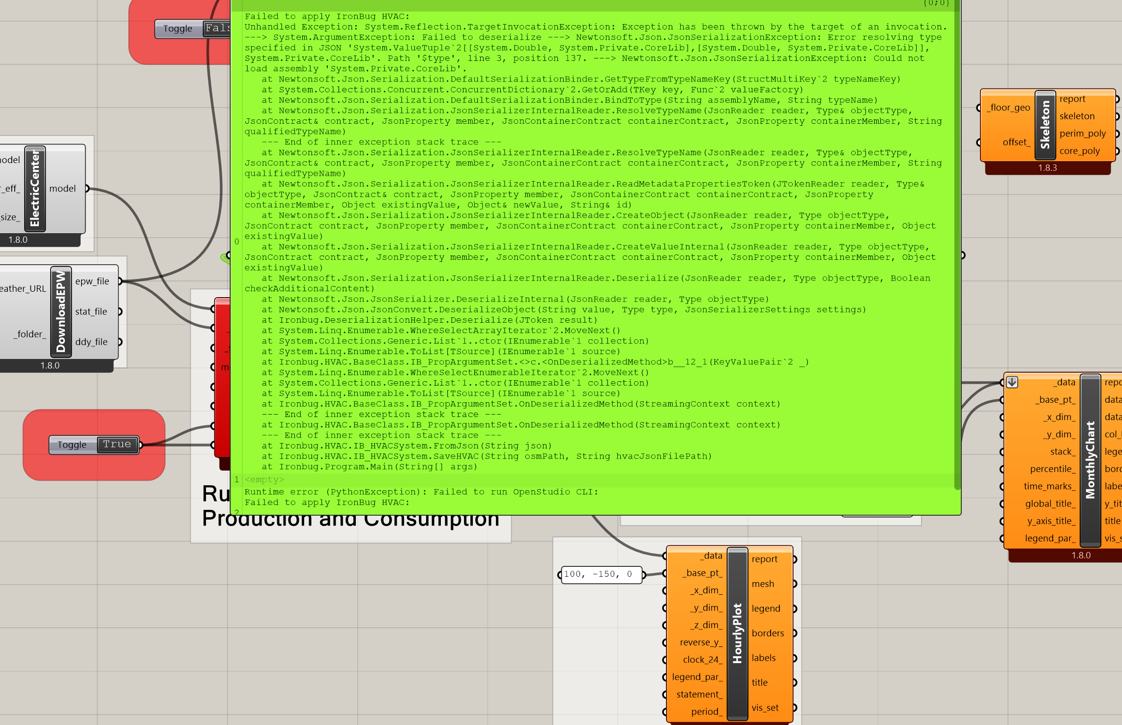

Hi all,
Ive been running this system through the pathway below with no issues so far but when i try to add it to a honeybee model it dosent like it. I need to attach it to a honeybee model so i can run it through a PV system

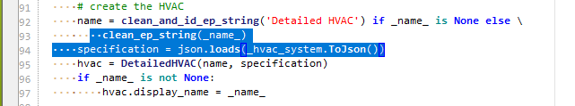

the full report says to traceback line 94 which reads as follows:
i recreated the error running the latest version of ladybug which provides a more detailed breakdown of the error.

Thanks for reporting the issue, @Nicholaskerr . I see a few different versions of components in your screenshot so you should run the LB Sync Grasshopper File to make sure that they are all using the same version that you have installed. Still, this doesn’t seem to be the root cause of the issue.
From the traceback, it looks like you have made an Ironbug system that can’t be serialized to JSON and that the Ironbug executable can’t translate to OpenStudio. So @MingboPeng is the right person to interpret the traceback and explain what is going on.
