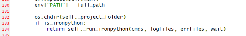

It’s the problem about windowserror in the Blockmesh and snappyHexmesh components.Just like the pictures.
It seems that someting wrong in the two .py file:runmanager_bluecfd.py and case.py,and I check the corresponding lines of the python scripts.
But sadly I have no knowledge about python,so I cannot understand what the meanings about the scripts.:frowning:

I have posted a solution here, but it requires a bit of coding:

@thomas.wortmann Thank you very very much! It works,that’s amazing!
I just changed the code in 45th line like your suggestion.Though I can’t understand Python but it is very useful advice!~:slight_smile:
