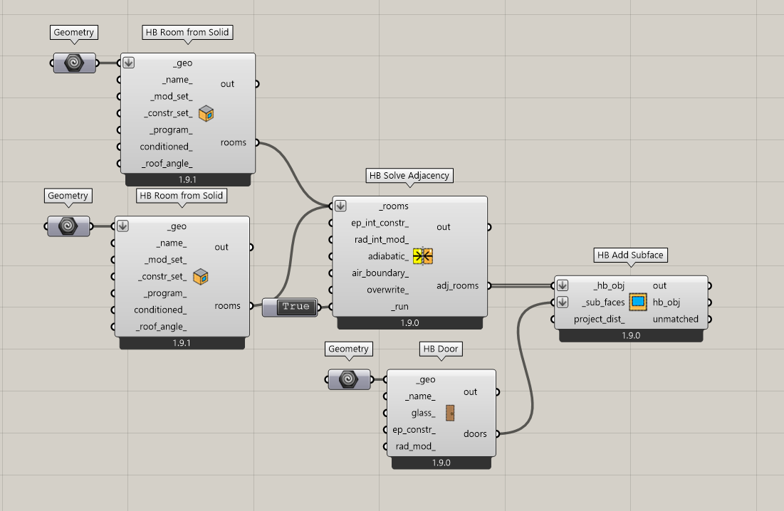

Hi @He1sH1gh if you use solve adjacency before adding the door it should be good to go, if I am reading your post correctly.
This here works with no error:
also just incase: make sure the door doesn’t touch any face edges
Hopefully that helps
Best
