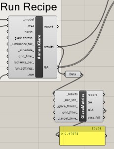

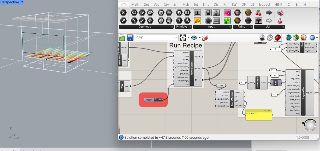

I was wondering if the posted screen captures are the correct method to calculate sGA? The default threshold is 0.4 glare and the hours include daylong, which should be fine for 95% of the time. Thanks
Hi @MahsanM,
Yes, that is the correct setup.
I see that the sample file in the LB Samples component does not include the post-processing component for sGA. I can add it to the file so it will be there in the future.
