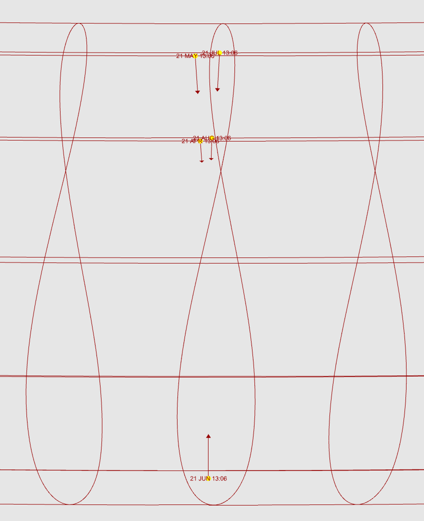

It seems the sun in Singapore at 13:06 on 21-Jun as shown in sun path diagram is not at the position where it should appear … and this happens only at that exact moment…

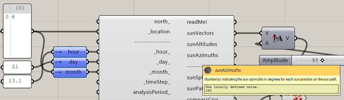

I wonder if it’s related to the calculation of solar azimuth which should be either zero or 360, rather than 180, for that moment.
If this is the case, the code for the sun path diagram probably can address this “once in a life time” moment to prevent the sun in Singapore from “teleporting” to the other side of the sky… unless that is the planned drama …
