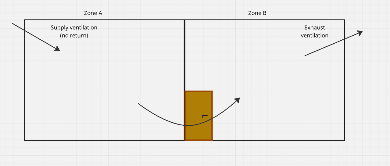

Hello, The question is: Is it possible to model a two-zone ventilation that meet the following criteria: Zone A has mechanical outdoor-air supply but no physical return-air duct. Zone B has mechanical exhaust. The zones are connected by a permanently open door modeled using AirflowNetwork components. I want EnergyPlus engine to solve the zone pressures and transfer airflow through the door, rather than prescribing the interzone flow with something like simple ZoneMixing so supply and exhaust mass flows must be included in the AFN mass balances. Did anybody of you already model such system? I will be gratefull for every insight since now I am not even sure if Honeybee / native e+ is capable to do it. In attachement is my .idf file I created already.
