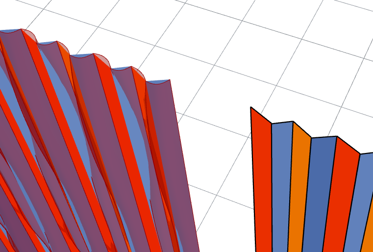

Hello everyone , My radiation analysis mesh becomes distorted and faceted when I increase the geometry complexity in Grasshopper/Ladybug. I want to keep the original surface quality and smooth form while still getting accurate radiation results.

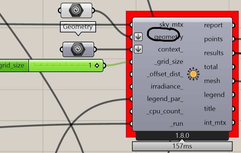

What would be the best workflow to separate the analysis mesh ?
Lower the _grid_size and you’ll get more mesh faces that approximate your NURBS surface.
I would also offset your mesh a bit from the face of your geometry. Some of the results might be getting artificially shaded by the geometry itself.
