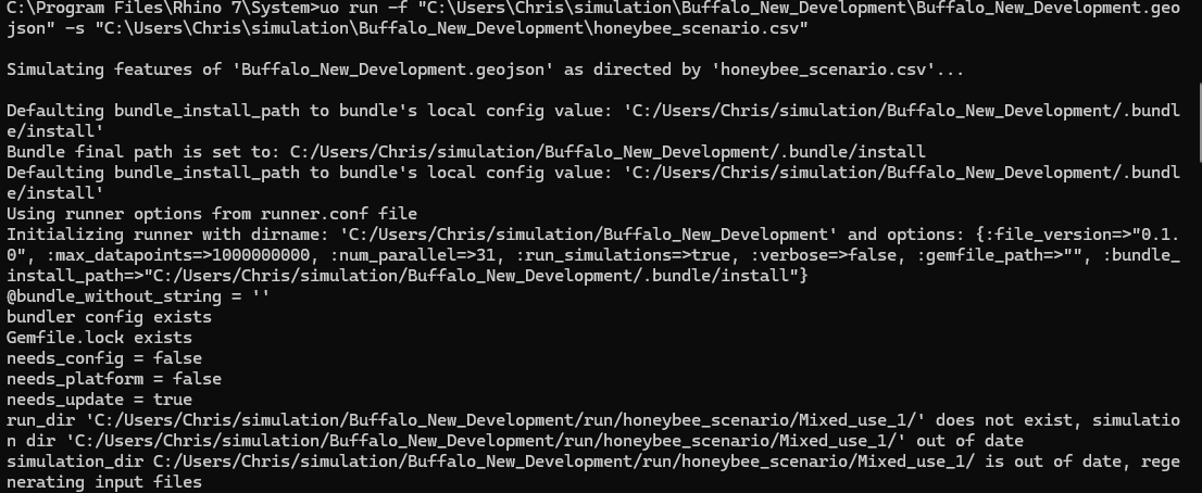

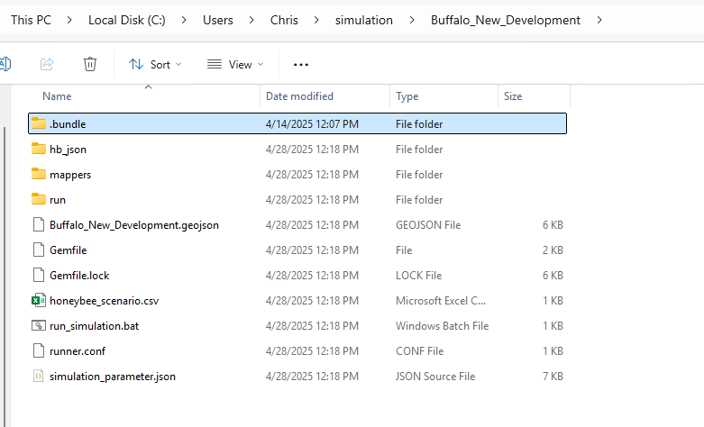

Here is a zipped version of the .bundle file from my machine:
If you unblock it, unzip it and copy it into the URBANopt project folder you are trying to simulate, this should hopefully prevent further gem downloads from happening for that folder. Let us know if that works.

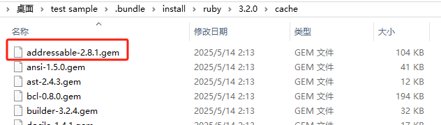

The version of URBANopt I am currently using is 1.0.1, and the version of PollinationGHinstaller is 1.57.7. These are consistent with the version used in the latest urbanopt_Gemfile.
Hey @ZhengrongTao ,
I am not sure that I follow where adressable version 2.8.6 is coming up. Version 2.8.1 is what is in the .zip file of the .bundle that I uploaded here and it’s the same as what is listed in the urbanopt_Gemfile:
If you are using URBANopt 1.0.1 and you have unzipped the .bundle into the correct place, the URBANopt CLI stdout should move pretty quickly from the needs_platform step without downloading any new gems like so:
… but maybe there’s still some small call that is happening to rubygems.org. Am I correct that you can’t access Rubygems.org at all from your machine? Or is it just a slow internet connection?

Hey @ZhengrongTao ,
I have one more thing for you to try, which is admittedly a very hacky workaround and will only be a temporary solution until NREL releases of version of URBANopt CLI that does not require downloading gems for each project folder.
You can open the following dragonfly source code file in a text editor:
"C:\Program Files\ladybug_tools\python\Lib\site-packages\dragonfly_energy\writer.py"
… and edit this line of code in the file:
You’ll just remove 'Gemfile', 'Gemfile.lock', from the list there. Then save the file using admin privileges. Then, you can copy these two files into the project folder directory that contains the .bundle that you unzipped:
Gemfile.zip (2.3 KB)
If you do that, the next time that you run an URBANopt simulation out of that project folder, you should see the needs_platform step is false, which I think means that any use of the bundle commands is bypassed, meaning is should be theoretically possible to run an URBANopt simulation without an internet connection.
Granted, this has the potential to break things for people updating from older versions of URBANopt. So I don’t want to make a change like this an official part of the dragonfly plugin. But I think this should hopefully unblock you.

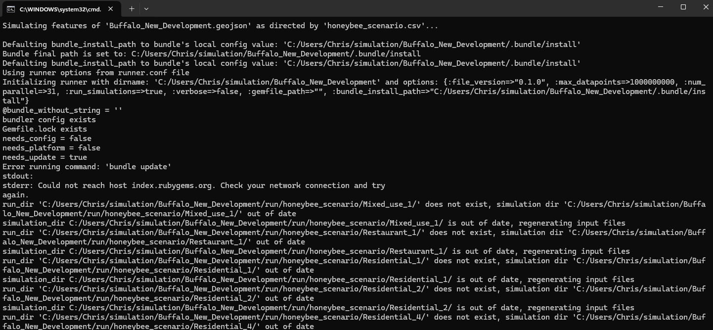

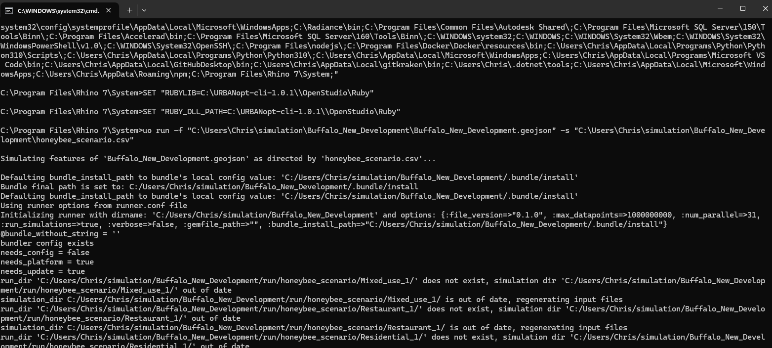

I had a call with NREL to discuss the challenges that are presented by the downloading from rubygems.org and they told me that they want to come up with a solution for it and put it in their funding requests for this year. So hopefully this will give us all some permanent fix without me having to engineer some major way to work around the whole URBANopt CLI on the dragonfly end.
Ok, yea, I just did a test on my end and confirmed that, with the workaround above, I was able to run an URBANopt simulation without any internet connection.
Granted, I still got an error printed to stdout that “bundle update” failed. But then it launches into a successful set of EnergyPlus simulations that complete:
So this is really the best that I can offer for the time being.
