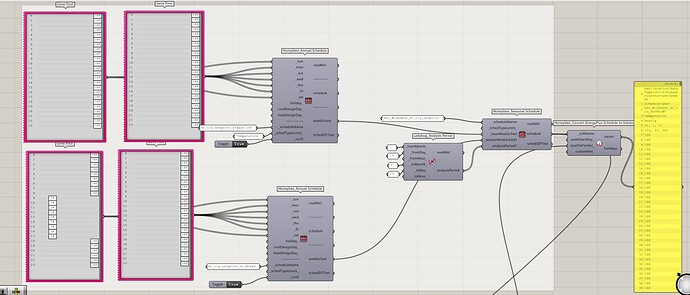

The EP went viral when it was plugged into the refrigeration schedule. What's the problem? Anybody know?

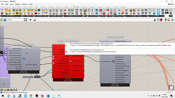

Is there something wrong with my refrigeration schedule? I hope someone can help me

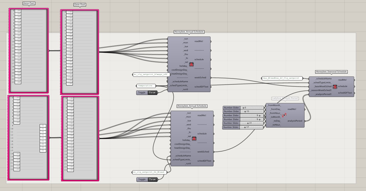

The error message say why the error happens. Your input is out of range for a fraction input (0-1). You need to change the scheduleTypeLimit for the second component.
请问采暖时间表 是这么设置的吗 我不知道对不对 温度节点是21
