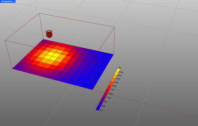

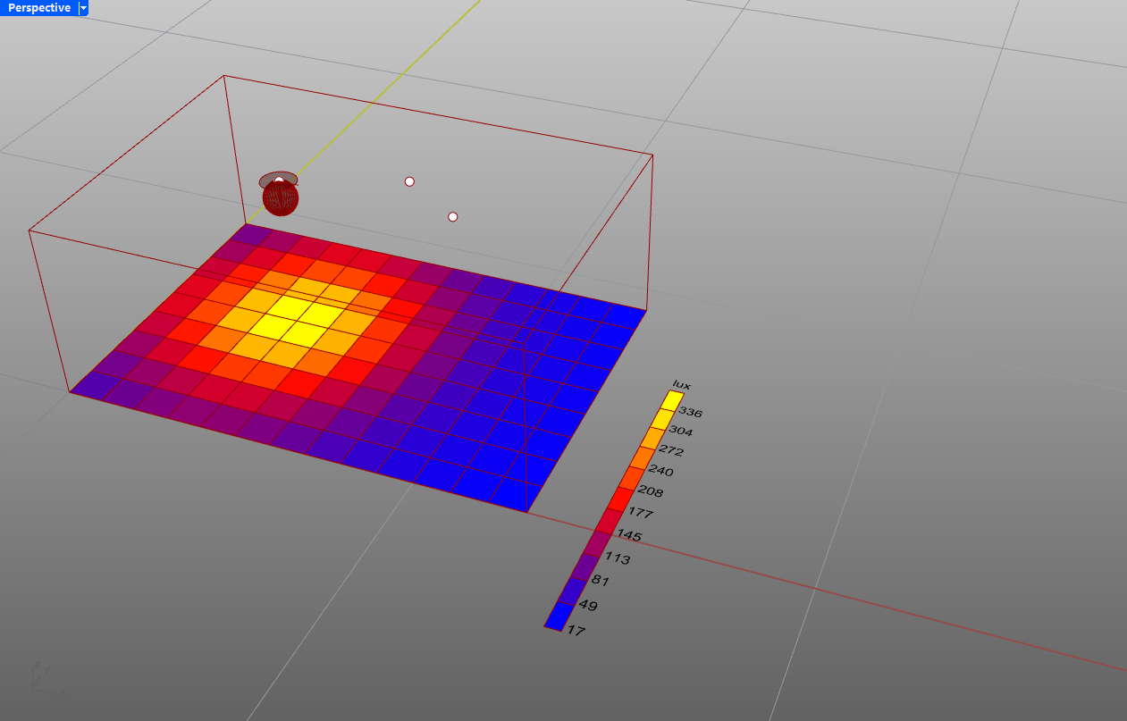

i followed the sample of electric light, but the result seems wrong when I check the illuminance in DIAlux. Did anybody know how to fix this?

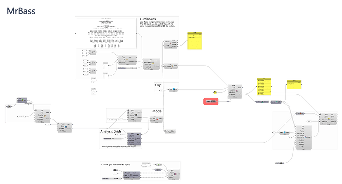

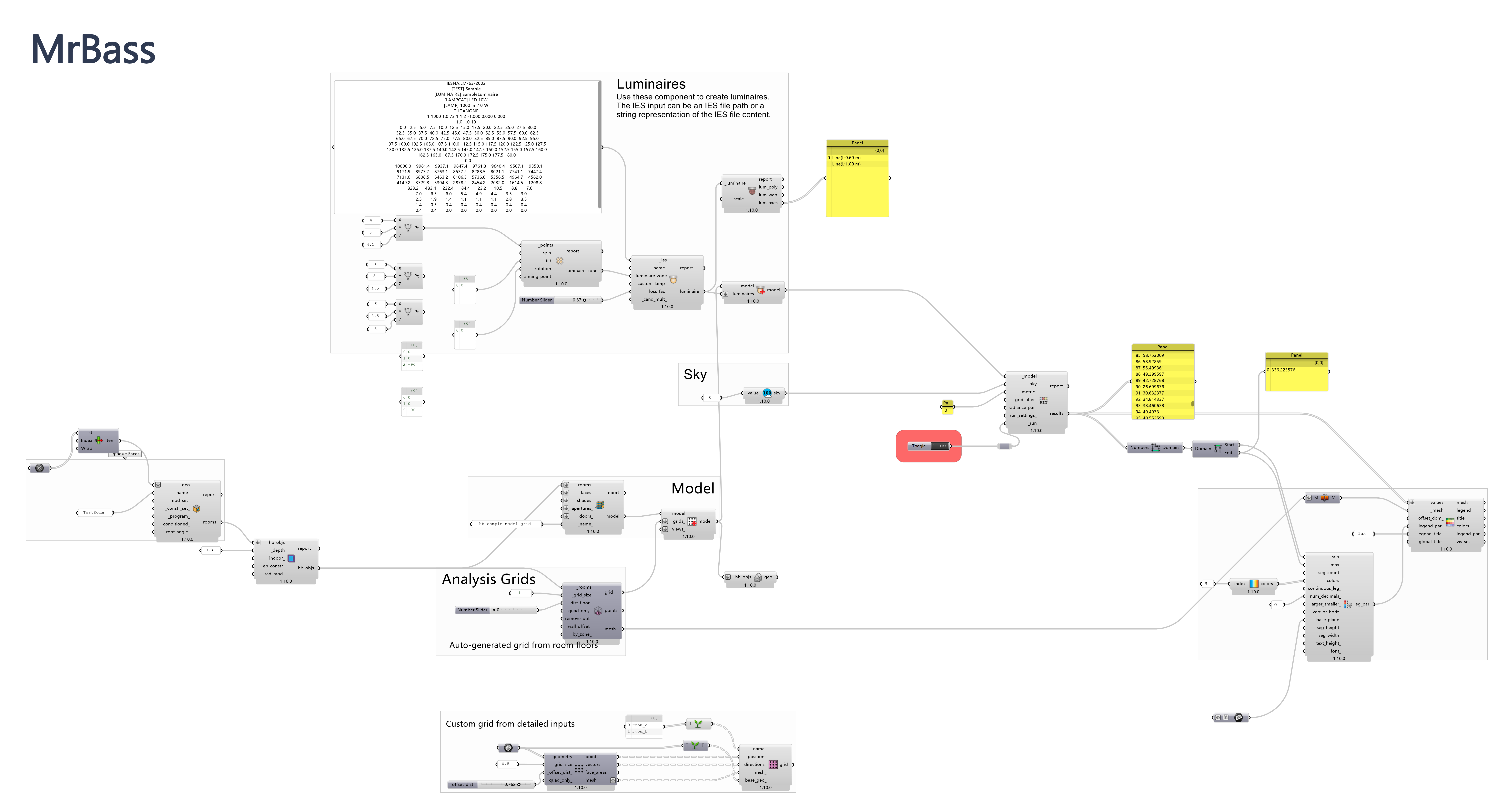

this is the grasshopper file
Its hard to tell based on the screenshot alone, nevertheless there are several hints there. You have not assigned radiance parameters or materials to the room. The grid height might and maintenance factor (LLF) might also differ from whatever it is that you have keyed into Dialux.
