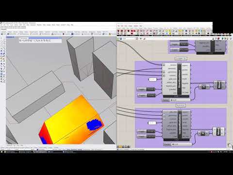

Hello, I am a beginner learning Ladybug analysis on Youtube, but I found that the Ladybug I downloaded did not have the Ladybug icon as in the tutorial. May I ask if there was any mistake in my downloading process?I know this is a basic question, but I would appreciate it if you could answer it.
The tutorial you are watching is for the legacy version of the plugin. If you downloaded the latest LBT they have updated a lot of the processes. In the latest versions (1.2.0 etc) you do not need to let ladybug fly anymore, so this component is not included.
