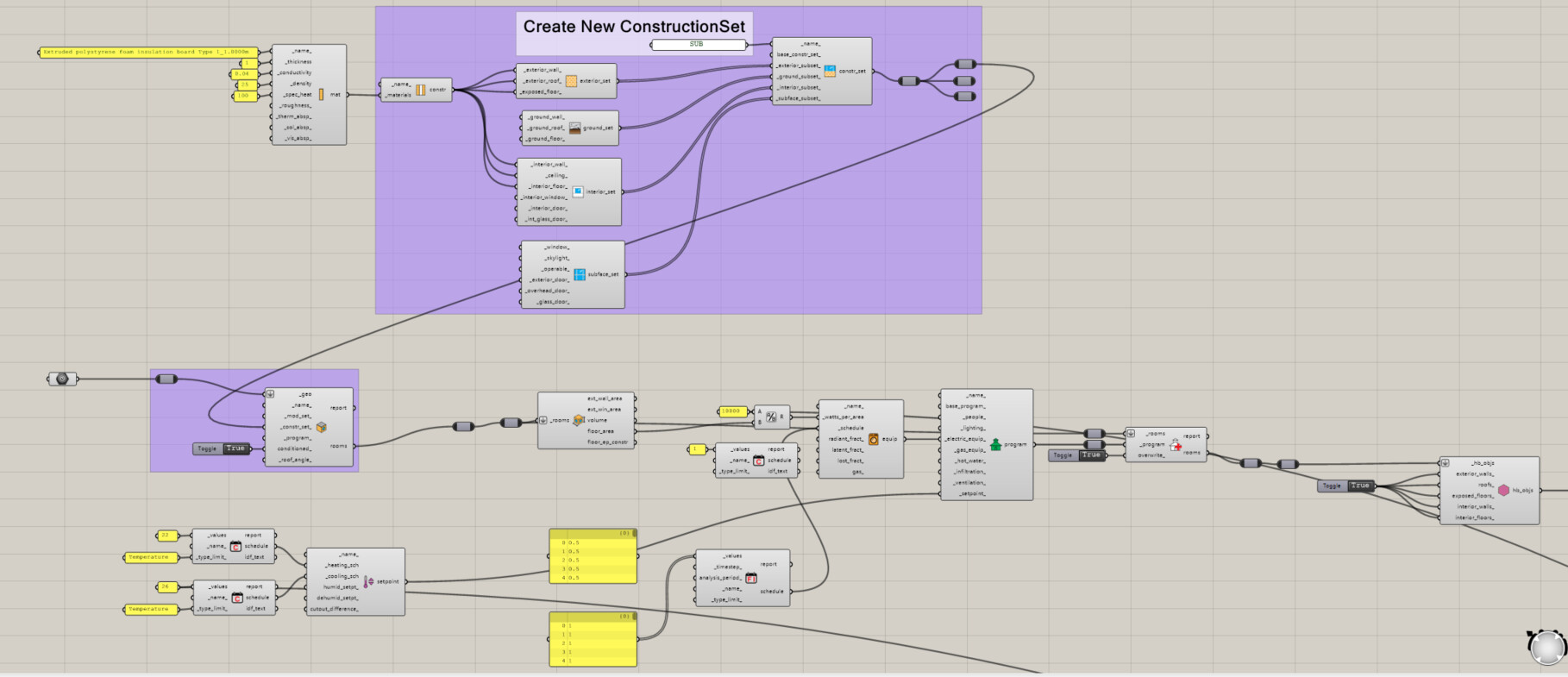

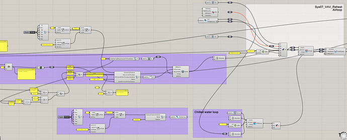

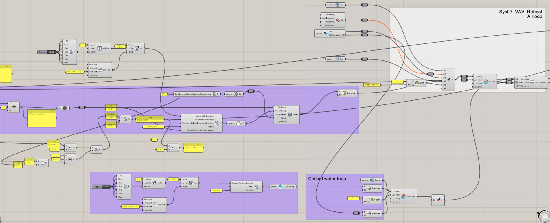

I’m trying to perform a simple calculation using HoneyBee and Ironbug.
Under constant conditions of 26°C outdoor temperature and 40% relative humidity, I’ve set the external load to zero by using 1 m of insulation plus an insulated boundary.
I’ve entered 10,000 W of equipment heat as the internal load, and calculated and entered the VAV supply air temperature (fixed at 16°C) and airflow rate required to handle that load.

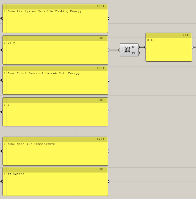

Although I’ve set the indoor temperature to 26°C, it’s rising to nearly 28°C.
Could there be some other load entering the room besides the equipment heat?
Please tell me why the set temperature isn’t being reached.
I’ve attached the GH file.
Thank you for your help.
I can’t upload the file, so I’m attaching an image instead.
It hasn’t reached 26 degrees.
