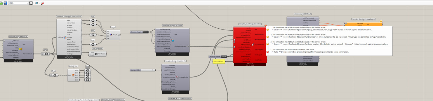

The simulation has not run correctly because of this severe error
Question:
  1. The simulation has not run correctly because of this severe error:
    ** Severe ** Weather Simulation requested, but no weather file attached.
  2. The simulation has not run correctly because of this severe error:
    ** Severe ** GetNextEnvironment: Errors found in getting a new environment
  3. The simulation has failed because of this fatal error:
    ** Fatal ** Error condition occurred. Previous Severe Errors cause termination.
    I found a similar problem in the forum. The solution is to change the version of openstudio. But I have replaced 2.5.0, 2.6.0, 2.9.1 and the latest 3.2.1. Can’t solve the problem。
    Please help me~~~
The Openstudio has changed several versions, which is still an error
Forgive me for being a novice and finding a mistake. The reason is that there are characters in the pathname given to climate data.
