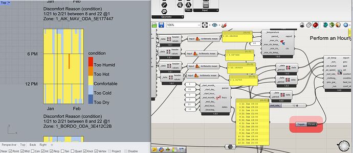

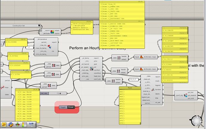

As I attached in the first image, I did thermal comfort analysis in 16 different rooms between 8.00 and 22.00 hours on January 21 and December 21. As seen in the second image, LB PMV Comfort shows 479 values in the comfort input. I don’t understand why there are so many values. I would be very happy if you could help me.
Thank you very much.
You have 32 days [21.1 to 21.2], 15 hours per day = 480 results [hourly].
I understand, thank you very much. I analyzed a total of 16 rooms. These values refer to all rooms. How can I find the analysis result of a specific room I want?
You need to check but i suggest grafting the rooms instead of the flattening that is the default in the input.
I’m not in front of that but this is the direction I’ll try.
I’ll try it the way you said. Thank you.
