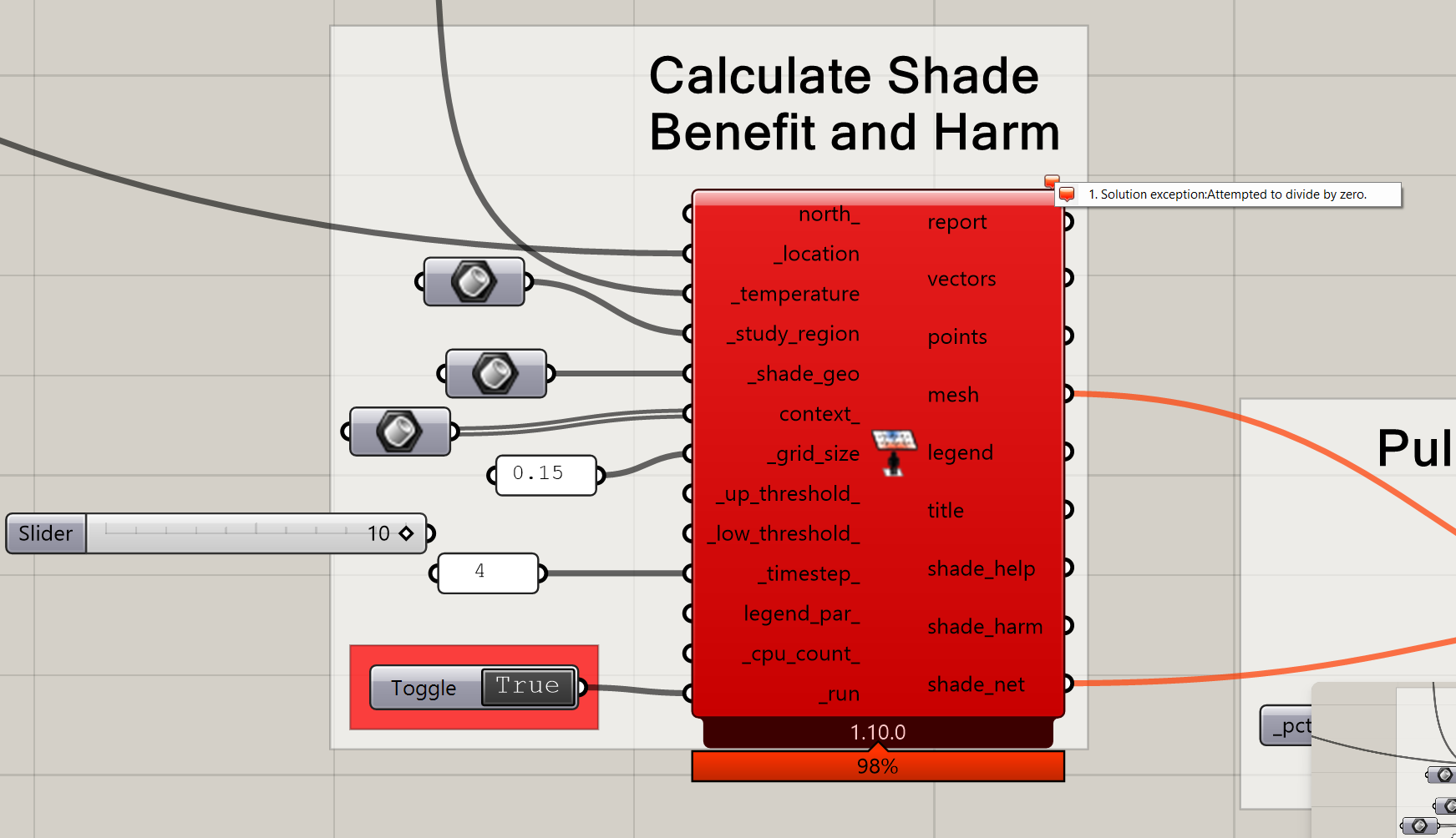

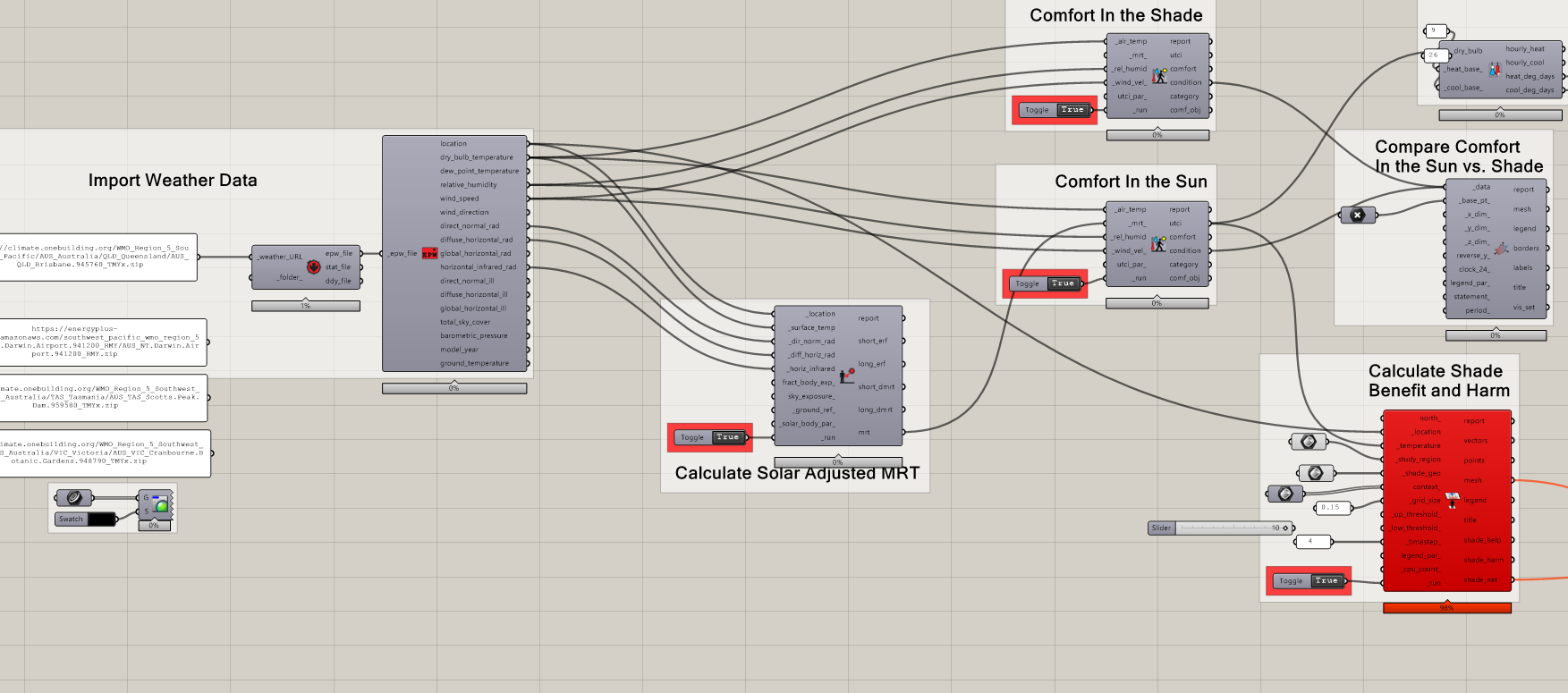

As a new user I cant upload files. But please see the screenshot for the script:
Much cappreicate for your help.
I can only upload one image once. Here is the closeup of the error mssage

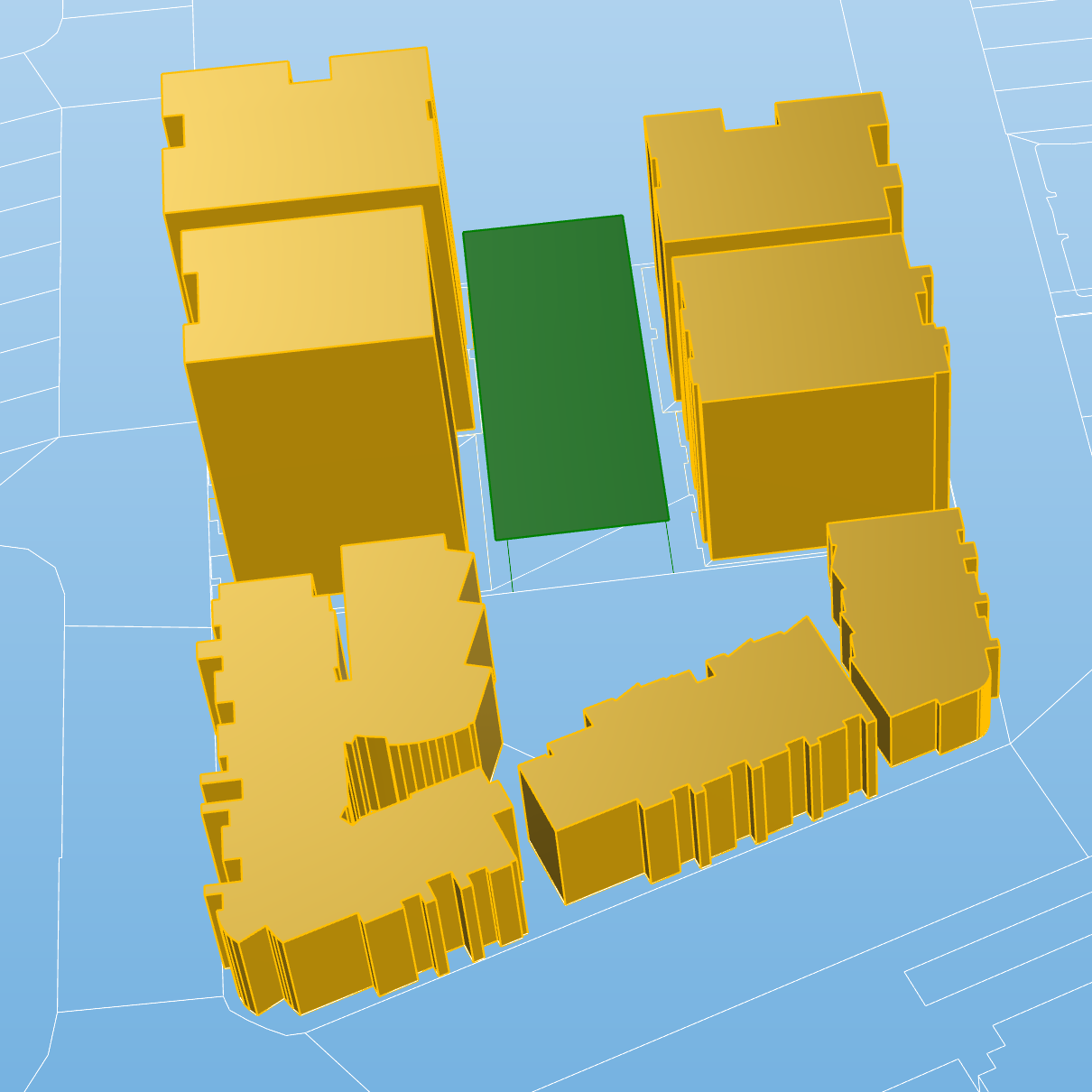

This is my context buildings and shade geo (green):

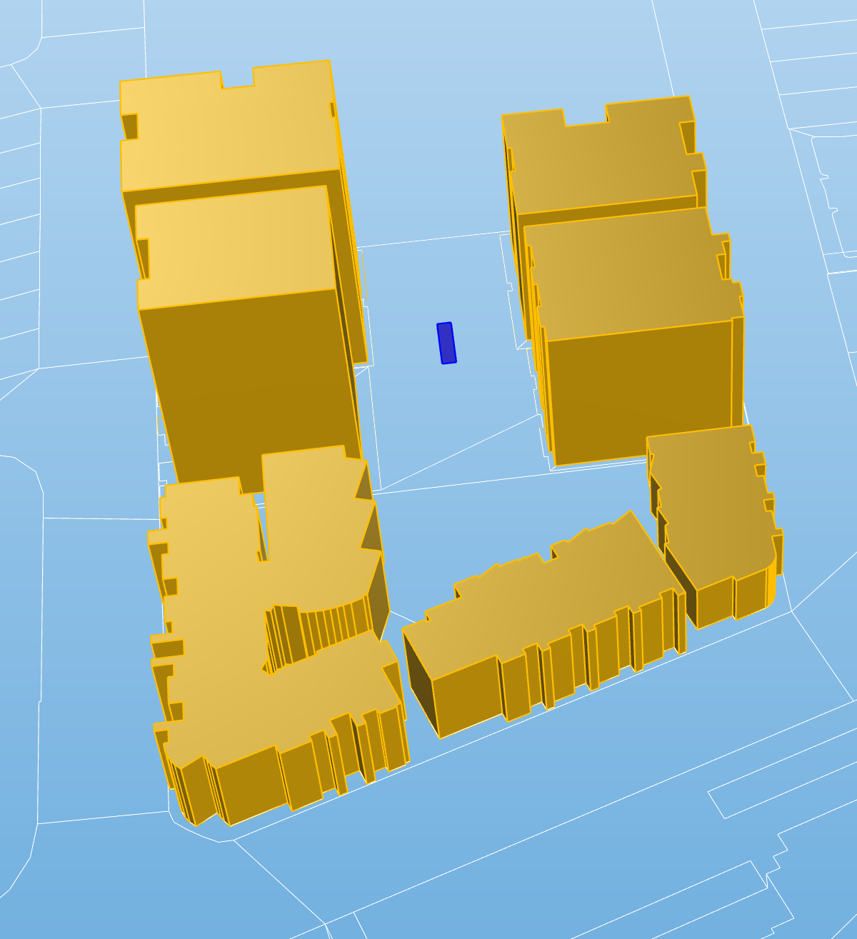

This is my study region (blue):

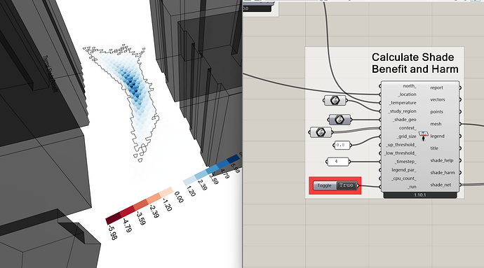

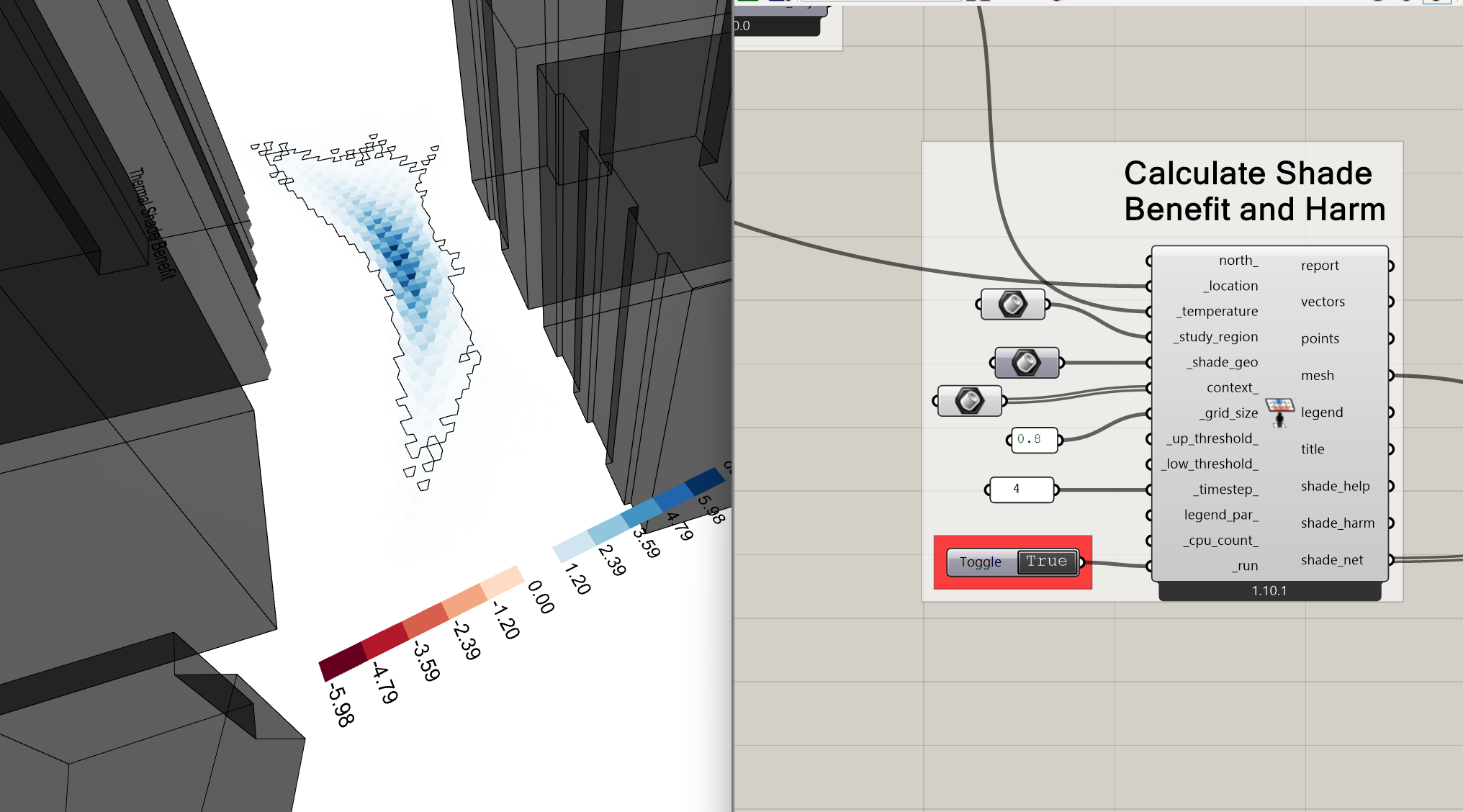

The issue was that Rhino meshing was producing a zero-area mesh face for your geometry when small grid sizes were used.
I pushed a fix here, which is now available via the LB Versioner:
… and here is a version of your file with the fixed component:
