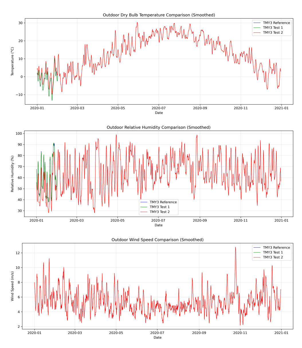

The code runs, but when I open the output microclimate-adjusted weather files (.epw) and plot the time series data, I see that while the UWG tool noticeably captured variation in outdoor temperature and relative humidity, there is no variation at all in windspeed between both test cases. I show these results with the following plots, comparing EPW files:
For comparing outdoor dry bulb temperature (°C), outdoor relative humidity (%), and wind speed (m/s):
I checked the EPW data itself, comparing between the reference base case EPW, the Test 1 EPW, and the Test 2 EPW, and can confirm that the wind speed values at each timestamp between both microclimate-adjusted weather files are indeed exactly the same, and not just very close in value. Simply trying to compare exact averages of outdoor temperature, outdoor humidity, and wind speed between each EPW file, I received the following, confirming my concern:

We see that wind speed between the reference EPW and the UWG adjusted EPWs is different, even if only by a microscopic difference, but wind speed from Test 1 and Test 2 is exactly the same.
Could someone in this community please help me understand if I am implementing the UWG tool correctly, or if perhaps my own understanding of how the UWG tool works to adjust weather files is incorrect? Or was the outcome I received actually expected? Or could this perhaps be a bug with the tool?
