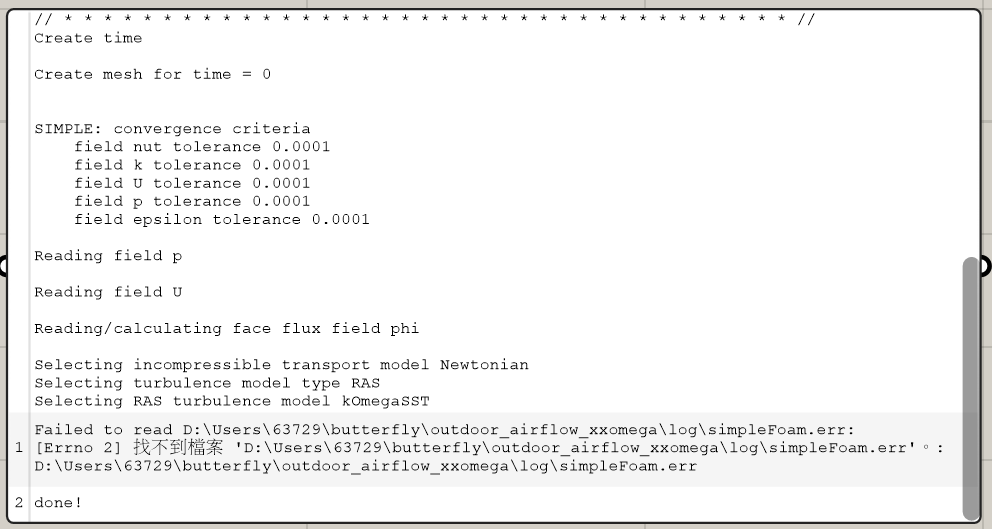

@minggangyin I figured what you meant is the turbulenceProperties under the constant folder of the case. I’ve already modified it as below:
/*--------------------------------*- C++ -*----------------------------------*\
| \\      /  F ield         | OpenFOAM: The Open Source CFD Toolbox           |
|  \\    /   O peration     | Version:  v1706+                                |
|   \\  /    A nd           | Web:      www.OpenFOAM.org                      |
|    \\/     M anipulation  |                                                 |
/* Butterfly 0.0.4                https://github.com/ladybug-tools/butterfly *\
FoamFile
version		4.0;
format		ascii;
class		dictionary;
location	"constant";
object		turbulenceProperties;
simulationType		RAS;
RAS
RASModel		kOmegaSST;
turbulence		on;
printCoeffs		on;
Also add the omega to 0 folder:

But the result still seems to be a failure:
You need to use BlueCFD terminal running the modified case.
