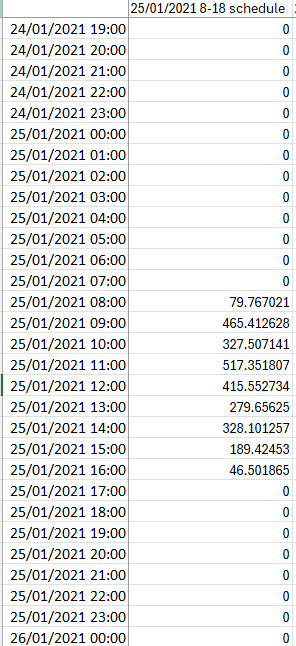

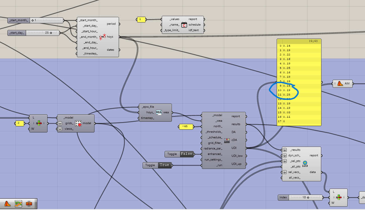

I applied a generic interior solar modifier set to one of my rooms and I’m running the radiance model just one day (January 25th) using the default schedule (8-18) as shown in the screenshot. I’m focusing only on the sensor 10 of my grid. The first question is: how is UDI calculated? The illuminance hourly data are the ones in the excel I shared. If I understood correctly, the UDI should be calculated as: N hours between 100-3000/ N hours occupied, that in this case is 7/11=0.64. How can I get 0.19?

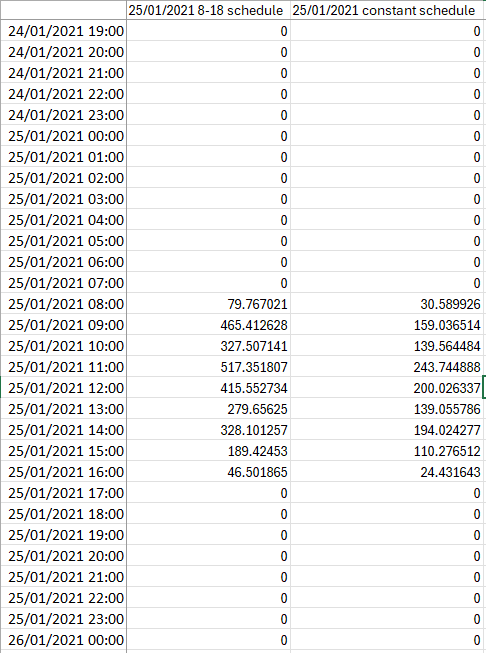

Moreover, I tried to input a constant schedule to the ANN component and I get different illuminance results, shown in the screenshot below. The natural daylight then depends on the occupancy schedule?
