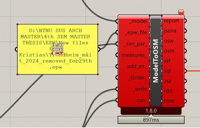

Hi! I’m having a similar issue here I think: When I’m using links from climate.onebuilding.org with weather data, simulation runs, but when I’m using an EPW that is working for my colleague (so the EPW should be alright), I get the same error on my 2 computers (I have recently installed Grasshopper with Pollination on one of them) and I’m getting this error: 1. Solution exception:No file was found at C:\Users\48882\simulation\MAIN_MODEL\openstudio\out.osw

Try removing Norwegian characters from your file name.

Thank you for your advice, I’ve tried it and unfortunately I still get the same error.

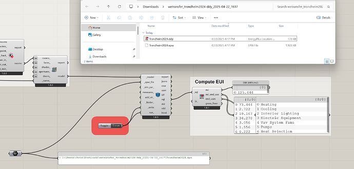

I just did a test on my machine with the latest development version of the “Model To OSM” component (version 1.8.3) and I was not able to recreate it:

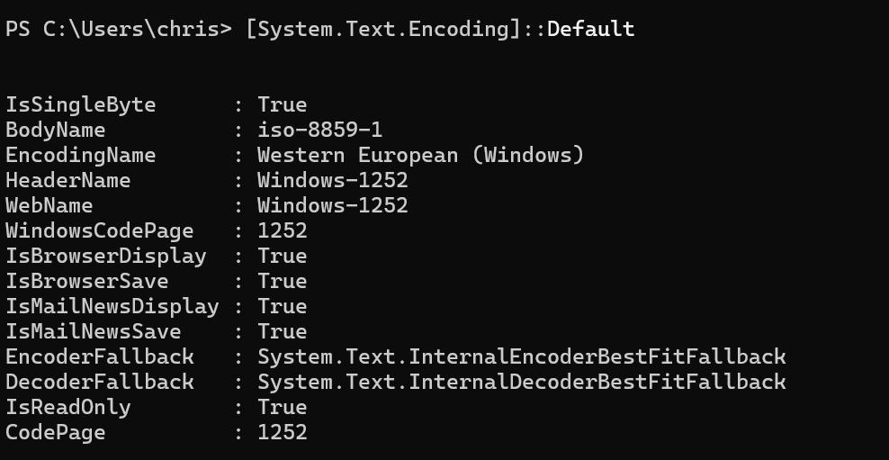

If that does not solve it, then I would ask what version of Windows you are running and what your default encodings are by running something like this in Powershell.
These are mine:
So mine are “Western European (Windows),” which seems able to handle the Norwegian characters but, if yours is different, than maybe your machine might struggle with them.
I have uploaded my versions with LB Versioner and error maintained, but than I’ve tried moving my epw from external disk, where I keep all my project files, to my PC (I’ve tried it before and it didn’t work), but than with the newest version it did! So I think combination of those 2 made it work. Thank you for letting me know about the LB Versioner, I didn’t know I could update so easily without reinstalling everything.
