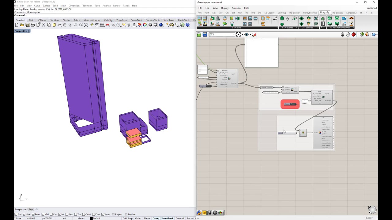

FYI, with dragonfly, there are also built-in workflows to export each building as a separate honeybee Model with surrounding buildings within a certain distance included in each honeybee model as context shade. This last part of this video shows what each of the Honeybee models looks like:
