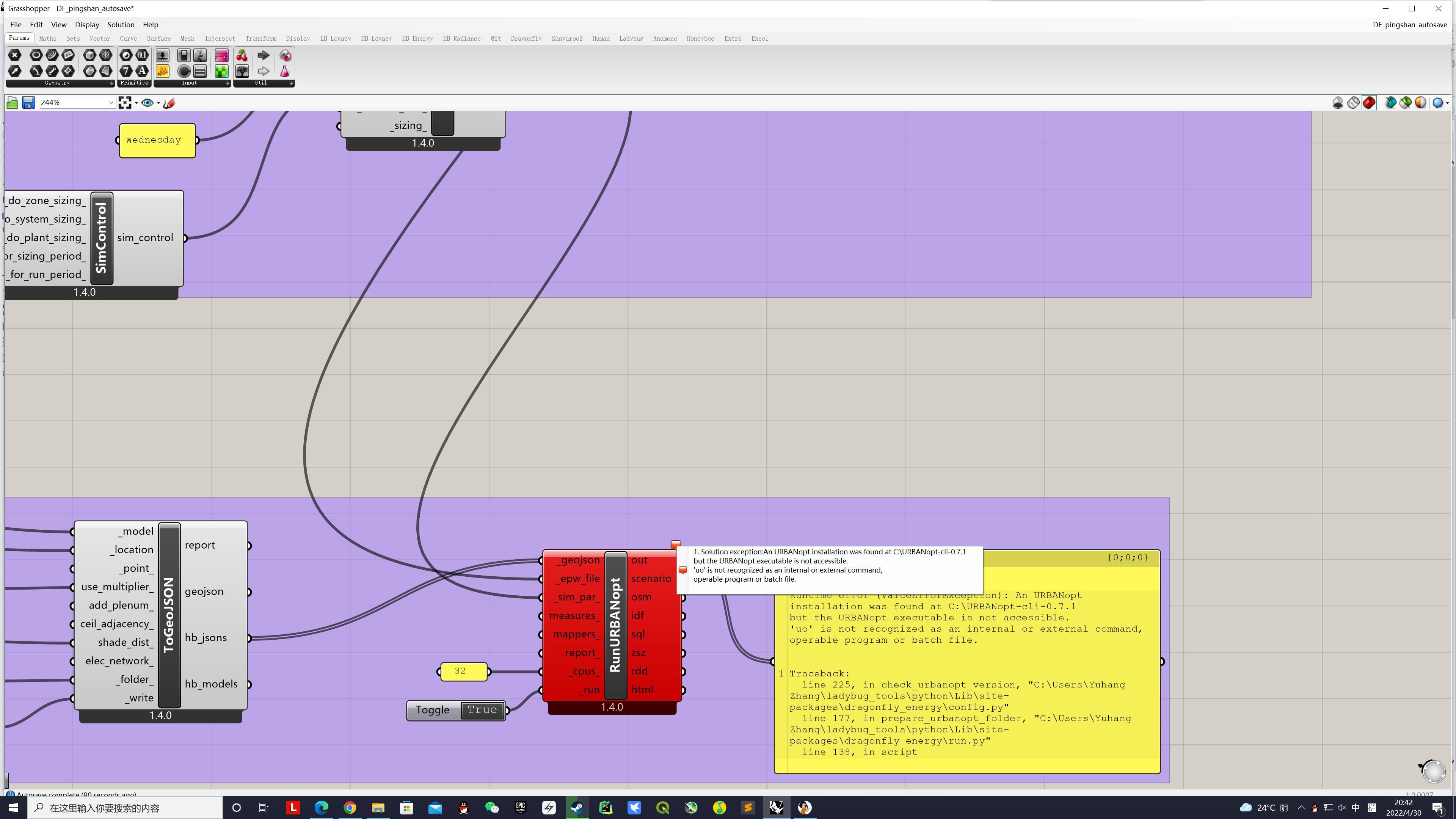

I am using RunUrbanopt but I got a problem in this picture, I think the URBANopt-cli-0.7.1 went wrong. But how can I fix it?
It looks like you have a lot of “Access Denied” issues there. My inference is it that your IT department has restricted your machine so much that you aren’t going to be able to run URBANopt. Can you get them to white-list the URBANopt-cli installation?
