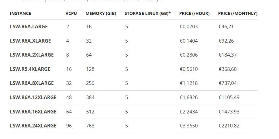

There is one simple solution for you. You can try to buy cloud services for Amazon or Google cloud, or bug hight performance hard drive with 16 core CPU and 128 RAM. You can select Windows system and install Rhino/Grasshooper/Ladybug tools.
