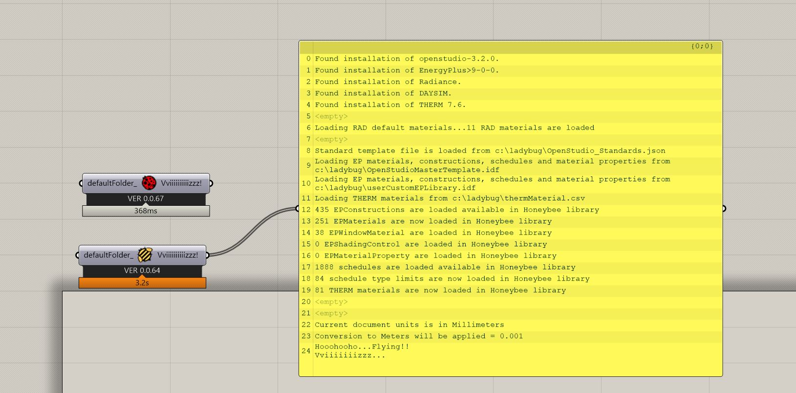

I have created an independent Grasshopper file with a very simple script and I get the same error.
Honeybee flies without problem but Energyplus and OS report an error.
Do you know how this can be fixed?

You better stick with the OS component
rather than using the E+'s
You can search the PINVOKE error in this forum. It was reported plenty of times, with plenty responses of how to fix it (@chris 's responses).
My bet is that you are using an “incorrect” E+ or OS version. Last OS version Legacy support is 2.9.
Hi Abraham,
As you recommend the following combination did the job:
Last Ladybug/Honeybee versions 0.0.69 and 0.0.66 respectively alongside OS 2.9.1.
Performing the simulation with Open Studio engine and only using legacy components in the script.
