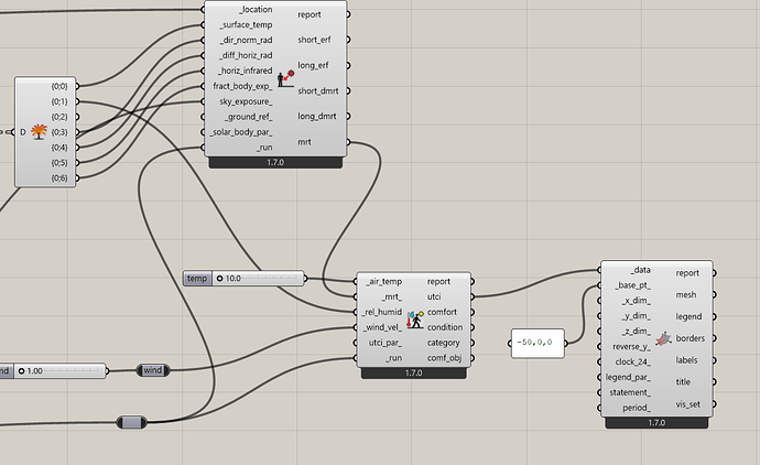

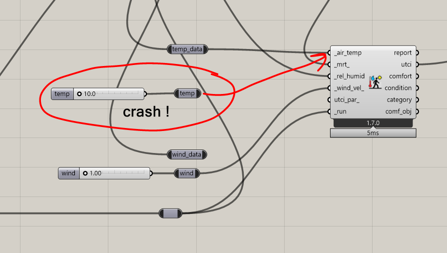

I use Ansys Discovery Live to get wind velocity and temperature data from specific points. I need to input this data into the Ladybug UTCI component in Grasshopper. However, when I connect a single value to the _air_temp input, Grasshopper freezes and Rhino crashes. How can I resolve this issue and successfully calculate UTCI without causing a crash?
utci_exp.gh (53.3 KB)
Hi @seghier ,
Sorry for the late response. I tried opening your script but it does not not recreate any “crash” for me when connecting the slider in your file labeled “crash!”
Is there something else that I would have to do to recreate the crash? Also, have you tried updating your CPU drivers? I recently had an issue where Rhino 8 was crashing on me and it turned out to be because my CPU driver was out of date.
