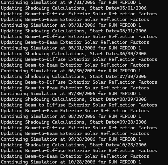

It looks like the EPW file I got might even be from 2006, not 2009. Are all EPW files this old? And does this affect every simulation output, or just the surface temperature one I’m running?
