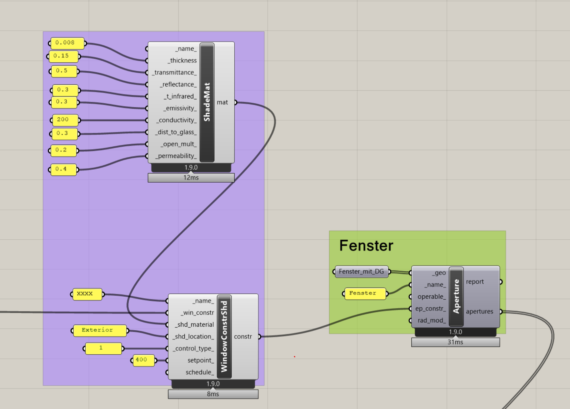

ValueError: Failed to find construction "XXXX" for OpenStudio ShadingControl
Why does my dynamic shade construction not work? I tried different names, also leaving the default name, but nothing worked. This is my script for dynmaisc shading:
I will be grateful for every help, thank you!
I also face the same issue, specially after moving to 1.9 from 1.8
