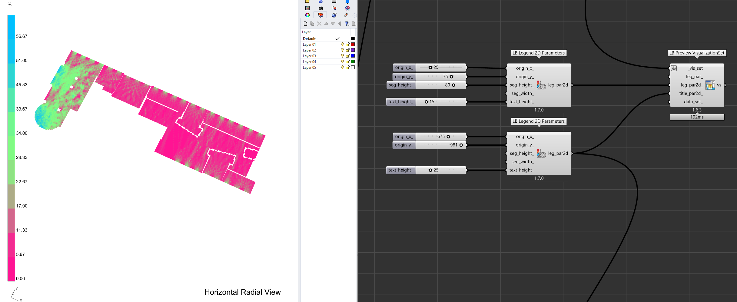

the image below is normal visualisation
the image below is preview vis_set

I wasn’t planning to include the title text in the default VisualizationSet of the sunpath since many people use the visualization set as a 3D visualization with the legend being oriented to the screen. So the 3D title can seem a little out of place in this case and it probably makes more sense to connect the title output of the sunpath to a Screen Oriented Text component. What if we only included a title when a projection is connected to the sunpath? When the visualization is 2D like that, I can see how the title makes more sense.
Hey @chris ,
I was imagining that the vis_set should have all the data attached to it, the place, the analysis period etc.
the LB Legend 2D parameters could have another input title_par2d. Please see below an example of how it could look like, in both scenarios.
2D legend
3D Legend
I just think that the vis_set should have the data linked to it, how its displayed it the secondary conversation. :upside_down_face:
Let me know your thoughts on it.
Thanks
Anuj

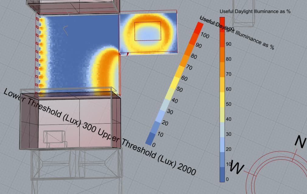

Just thought I would add my 2 cents worth - another use-case.
I will look into the screen-oriented text option, but the option here shows the way I have been orienting the global text for UDI calculations - where I am asking the students to document WHY they have chosen the lower and upper limits based on their building type. Both approaches documented. It would be helpful not to be separately tracking screen-oriented text and vis-set placement…

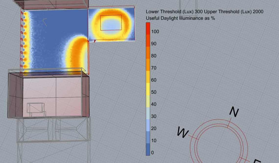

And a bit more experimenting, and I can see that this may well be a more robust way of working:
resulting in
