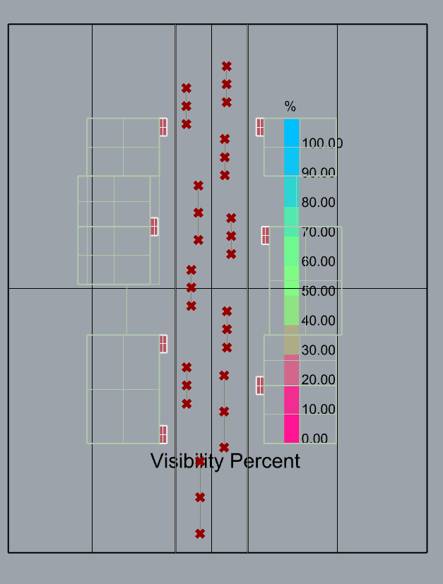

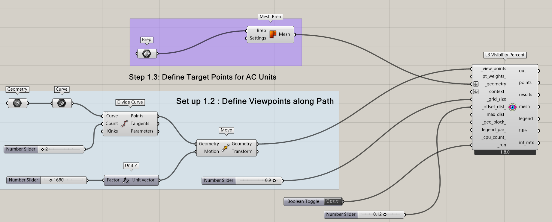

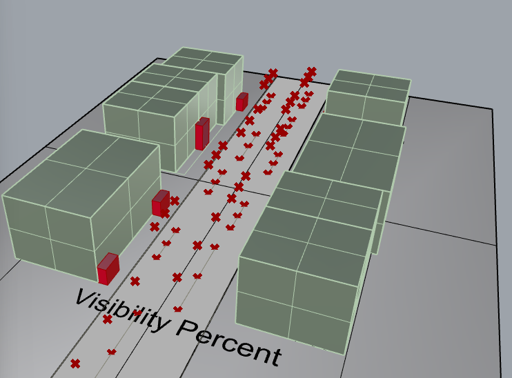

I am currently experiencing an issue with calculating the visibility of AC units in the street from a pedestrian viewpoint. I used the “Visibility Percent” component to run the simulation, but the results do not seem correct. I think I might be doing something wrong.
In the image, the street is shown with red boxes representing the AC outdoor units, and the points represent pedestrian viewpoints. The second image shows my Grasshopper definition.
I feel like I might be using the wrong tools or not setting things up properly, and I’m a bit confused. I would really appreciate any guidance or suggestions on how to approach this correctly.
this is second picture
and this is the result of the simulation
Switch the _geometry and the _view_points. Use the LB Generate Point Grid component to make a grid of points from your AC boxes.
