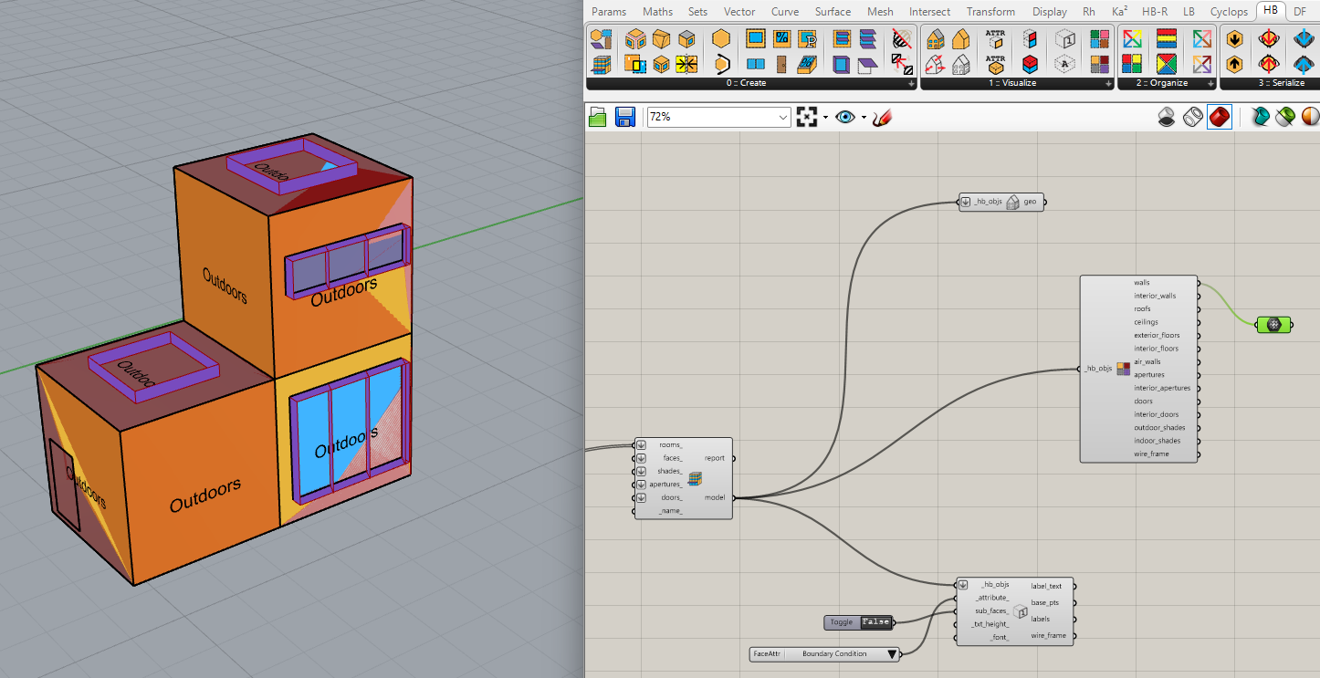

I am facing a problem when i put a mesh component to see more clearly my geometry model using Visualize By Type: It dont shows the geometry that i want to see:
Using honeybee 1.9
geometry-hb.gh (50.9 KB)
Using honeybee 1.9
Hi @joao.pires.i you should just have to hide the geometry preview so the visualize by type mesh isnt interfered with visually
