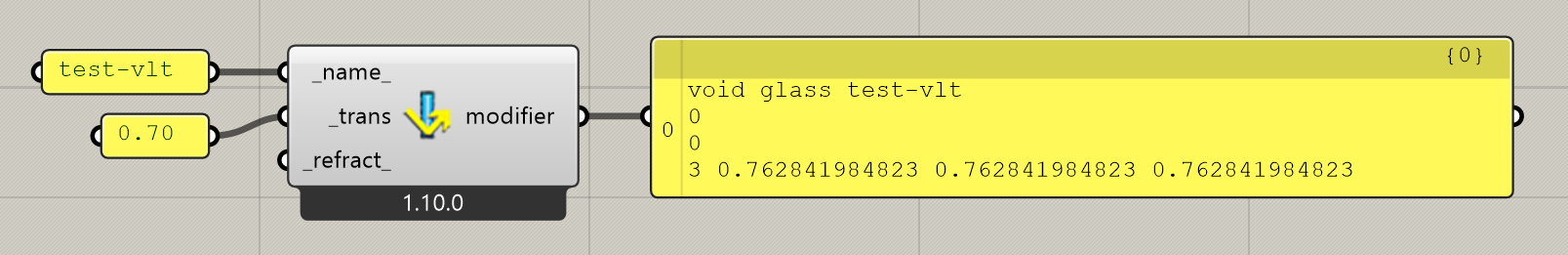

When specifying the Visible Light Transmittance of the glass, why does the input vary from the output (see image below)? Am I missing something?
Thanks,
Stefanos

Be aware that the input is the Transmission of the material and the output is the Transmissivity.
According to Radiance reference, the equation to calculate the later is:
tn = (sqrt(.8402528435+.0072522239TnTn)-.9166530661)/.0036261119/Tn
thanks for the clarification :slight_smile:
