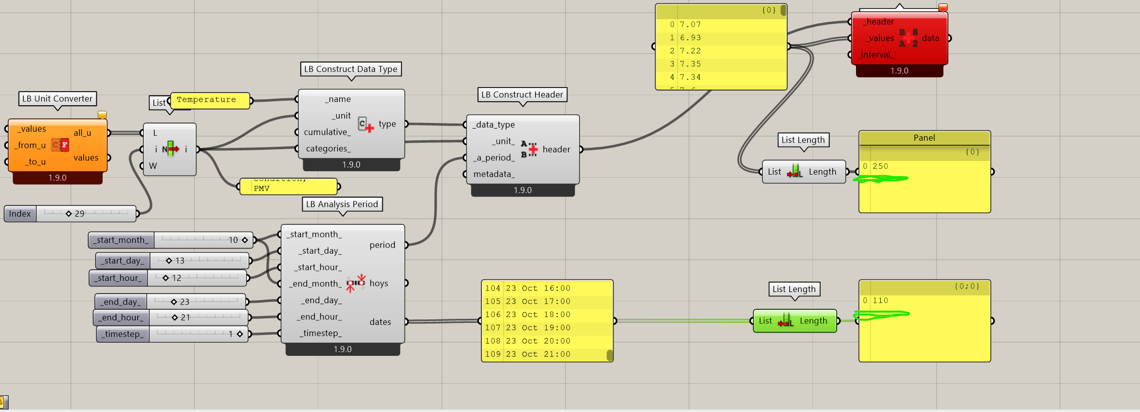

I wanna create a weather data by using LB components. However, it has error in LB construct data. It shows “1. Solution exception:Length of values list must match length of datetimes list. 250 != 110” .
Coud you please check it out?
I have recorded weather data from 12 P.M and it does not have any limited time at the end. In this case, I can not go forward.

Hi @zahrashirzadnia your values list is longer than the analysis period you have created, see green underlines:

Thanks for your reply.
Yes, that 's right.
I figured out how to proceed.
