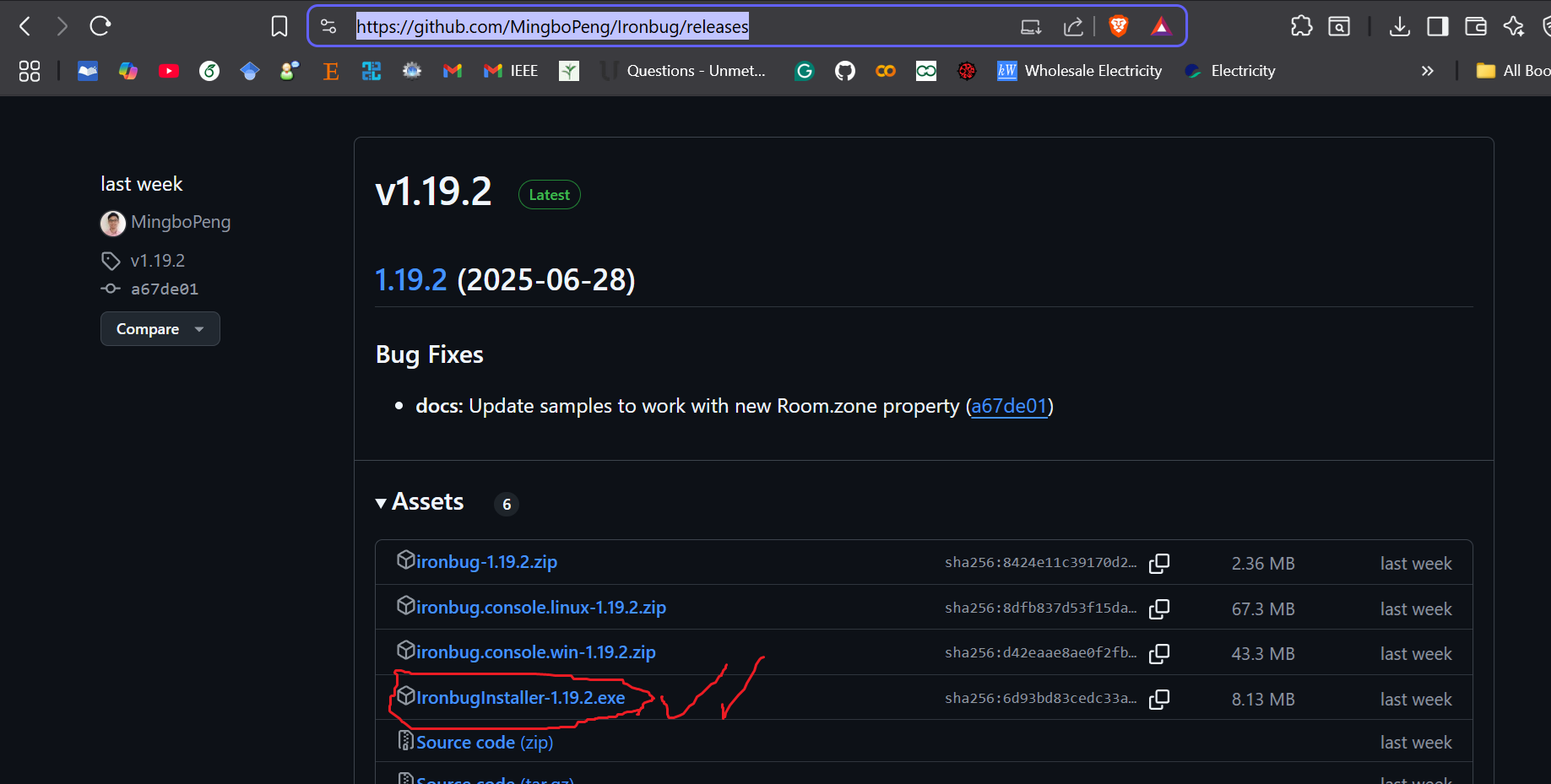

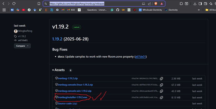

The IronBug version forthe new release of Pollination ``1.65.2’’ is IronBug 1.19.2
The updates for the IronBug do not follow the same speed. If there is an update for the IronBug in this link you can download and update it using the installer; it will update only IronBug components.
(I can see that the HVAC visualization component specifically designed by the IronBug team is not included in the new version (1.19.2))

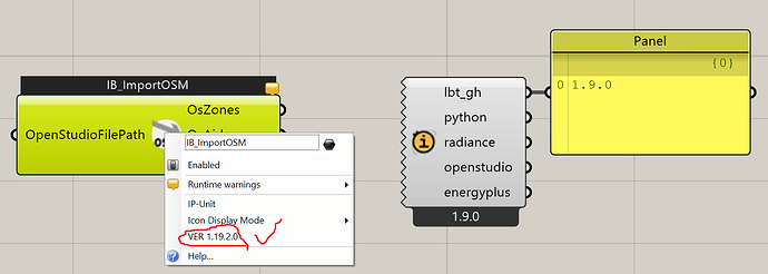

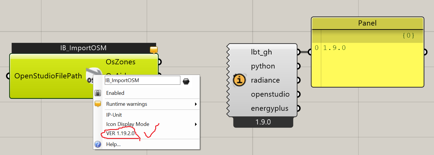

I faced that mismatch below:
The challenge is that IB is developed with a different style compared with LB/HB. A component like IB Versioner, similar to LB Versioner, is not developed to cover this challenge.

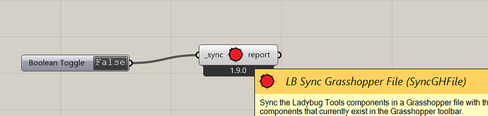

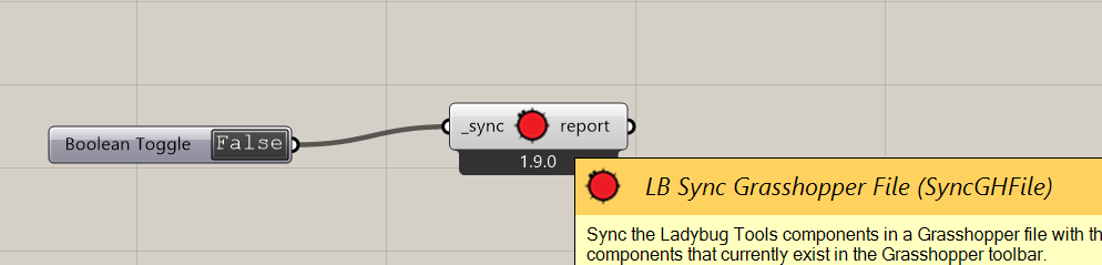

However, in general, HB/LB/IB being installed with the One Click Pollination file are completely synced and working. As a suggestion for your class, you could inform and set up your students to install the latest available version of Pollination. Then, for teaching them using previous simulation files, they need to run one component: LB Sync Grasshopper File.
This component updates all the components from the old simulation file to the version of installed Pollination on the machine (except those for IronBug).

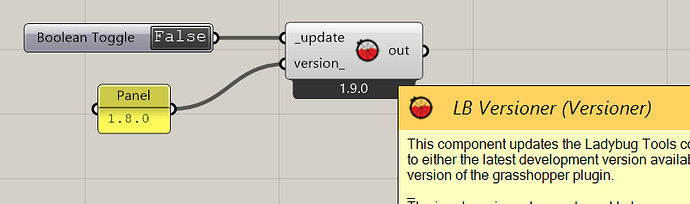

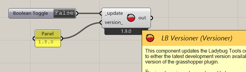

@MichaelDonn there is also another component: LB Versioner
With this component, if the version_ is blank, this component updates all the LB/HB, except Ironbug, in the simulation file to the latest released version. By joining a description describing the desired version for the component, you can downgrade to the version that you are interested in having.
