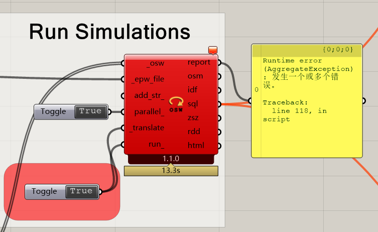

When I open this load_sharing_example.gh file , I find a component reports an error
please help me :smiling_face_with_three_hearts:
@l515220019 ,
I can’t read the error message but I know from experience that you won’t see the “real” error message unless you set parallel to False. That way, you’ll see the full traceback for the failing OSW.
okay thanks for reply,I found a solution because my unit was set in millimeters, so the error was reported.
