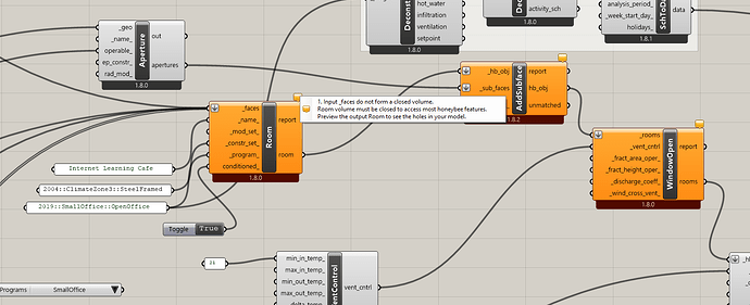

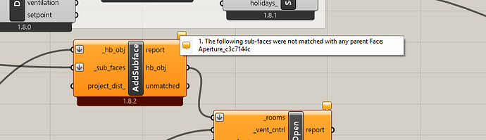

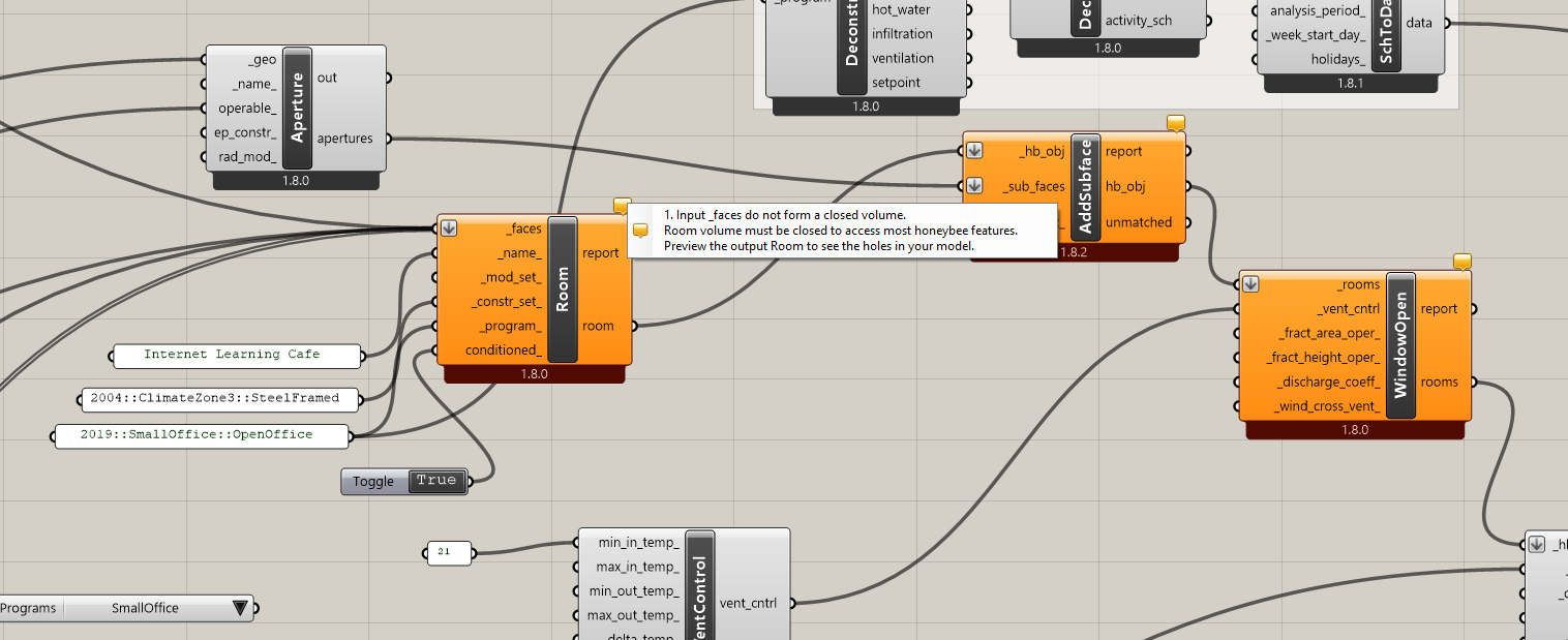

Where am I wrong in using Honeybee and Ladybug?
Idont know where iam wrong, this because iam wrong make 3d in rhino?
Hi.
Hard to tell, without more info, but it seems that your room is not watertight. So yes , there is something wrong with your 3D model.
In addition, it might be that your window is not on a surface, but this might be caused by the other error.
Yours,
Little Buddha
