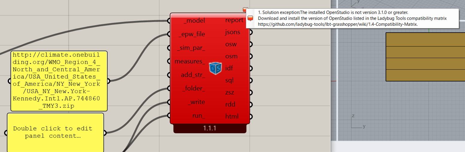

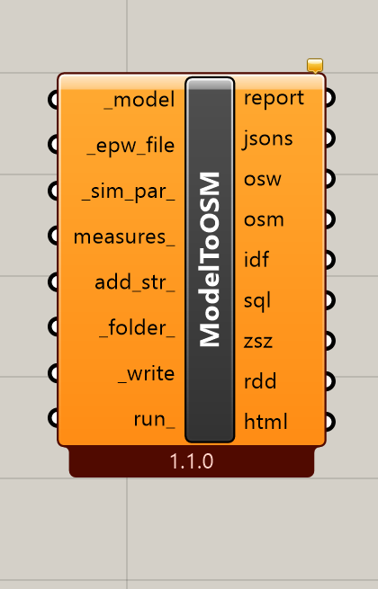

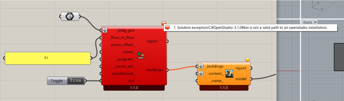

I have created a script, but there has been a problem with the OpenStudio, as the two images show. After I had received the warning in the first image with OpenStudio 3.0.1 that I had been using, I installed version 3.1.0. However, I have received the warning in the second image.
I was just wondering how the problem could be solved.

have you checked the compatibility matrix?
LBT 1.1.0 is compatible with OpenStudio 3.0.1, the LBT dev version with 3.1.
it’s not clear to me which one you are using.
Hello, thank you very much for replying.
I was just wondering how “HB Model to OSM” in LBT 1.1.0 could be found. Some of the components that I have got have shown 1.1.1 rather than 1.1.0.
Thank you
Well, I haven’t updated in the past weeks, so I have 1.1.0:
Maybe try updating with the LB Versioner component, it lets you specify an update target:
I’m not 100% sure, that it will solve your issue, I haven’t used it before.
Thank you very much. The script has started working.
